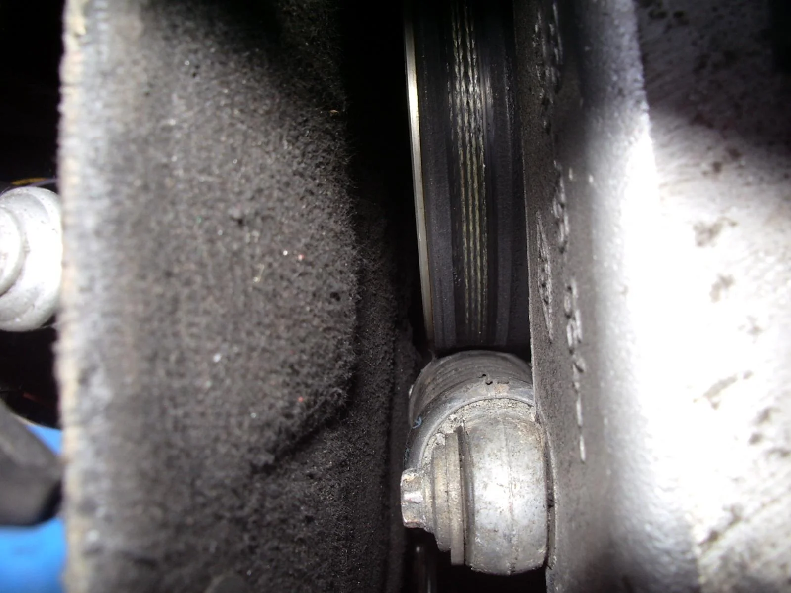

Just lifted the bonnet today to discover what looked like bits of rubber around by the top mounts.
Upon further inspection i noticed the belts dont look very good at all and believe they have been rubbing ( dont have a clue which bit it is they're rubbing on! )
I've taken a few pics & the belt looks to have worn quite a lot.
I had both the cam & aux belts done at a local garage in feb just after I bought the car, is it possible it may not have been fitted back up together correctly?
Your advice would be much appreciated!

I'd not drive the car at all, and call the garage asap Monday morning.
Let them take a look at it once you've told them your concerns.
  Lionel Richie
do NOT drive it!
that looks like a seized aux belt tensioner causing that, ie garage didn't change the aux belt tensioner and idler, school boy error on a 172/182

I only popped the bonnet to clean around and noticed bits of rubber shavings.
I do remember when they fitted it that they said they had a real struggle with the tensioner on it!
Hopefully its not affected the cambelt in anyway :dapprove:
I had it done at a garage literally next to where i live.
So going on the picks what should i be asking them to check they replaced? The aux belt tensioner is it?
When i first had it done i noticed there was about a MM gap maybe even less between that little spring and the belt itself, is that normal?

From the stuff you've quoted on the invoice it looks like they haven't bothered with the Aux belt tensioners, which would agree with what Fred said.

If it just says 'replaced serpentine belt' - then that's all they will have done. I had exact same issue when I checked my service history.
The majority of garages get into the habit of just fitting the belt and think the tensioner will be ok. This is not just on clio's, it's ALL makes and models.
You tend to fine the bigger garages and the specialists will change the whole lot - because they have the knowlege/how to and reputation to keep up. It's simply not worth changing just the belt.

I know its a long shot but just for comparison could someone take a pic showing the aux tensioner & the belt on their car so i can see what the gap should be like.

I know this problem very well indeed. The tensioner is broke. No need for pics there should be a 8-10mm gap between the tensioner and the belt. DO NOT DRIVE! NEW BELT AND TENSIONER KIT NEEDED>

This might sound a really REALLY stupid question but if the tensioner breaks how does that cause the gap between the tensioner & the belt to get as close as it is now?

ITs already broken!!! the spring is keeping it together. ( Imagine you have a pencil with a spring over it and you break the pencil, the 2 bits of the pencil have no where to go due the the spring holding them in so the spring get pushed out in the middle . . hence thats why its rubbing on the belt)

not quite what happens
The tensioner is leavered up under spring tension to fit the belt. The pivot rusts and stops the tensioner moving freely, so when you release it, it doesn't move sufficiantly to tension the belt

Cant believe the difference in the pics between yours & my one!

Just to say a big thankyou to all who commented and for all ur help & advice. I picked up the new aux belt & tensioner kit from Renault yesterday and it has been fitted today & fingers crossed there will be no further problems!
