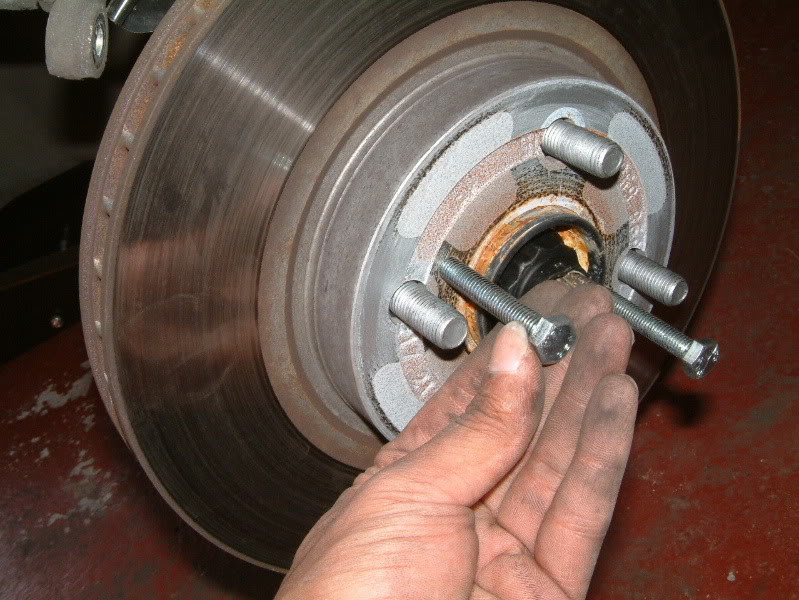

once the wheel is off and you have removed the caliper there should be two bolts holding the disc on remove these
and the disc's should just come straight off you may find there stuck fast, use a persuader more commonly known as a hammer with a rag wraped round it to tap the back of the discs they should come off easy enough though.

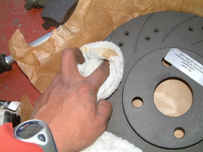

clean the new discs, I use meths but any brake cleaner will do as most companys put a layer of stuff on the discs to stop them scratching in transit
etc,

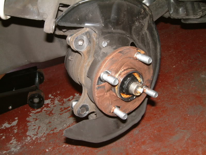

Then get out the copper grease, and give the hub a coating

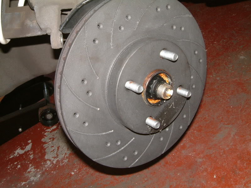

Put the new disc on the hub
Then Refit your Calipers
job done
