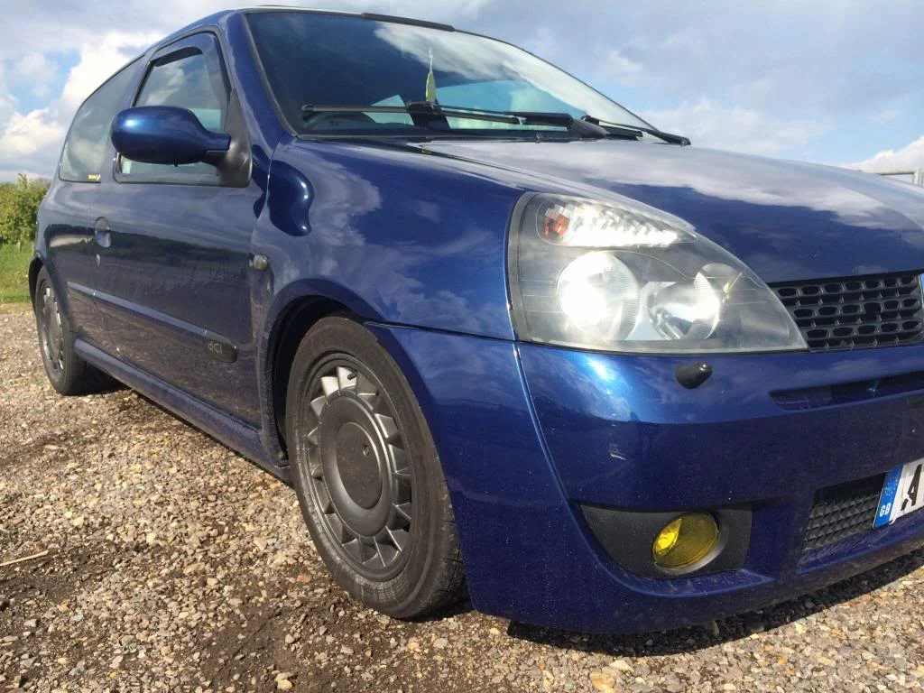

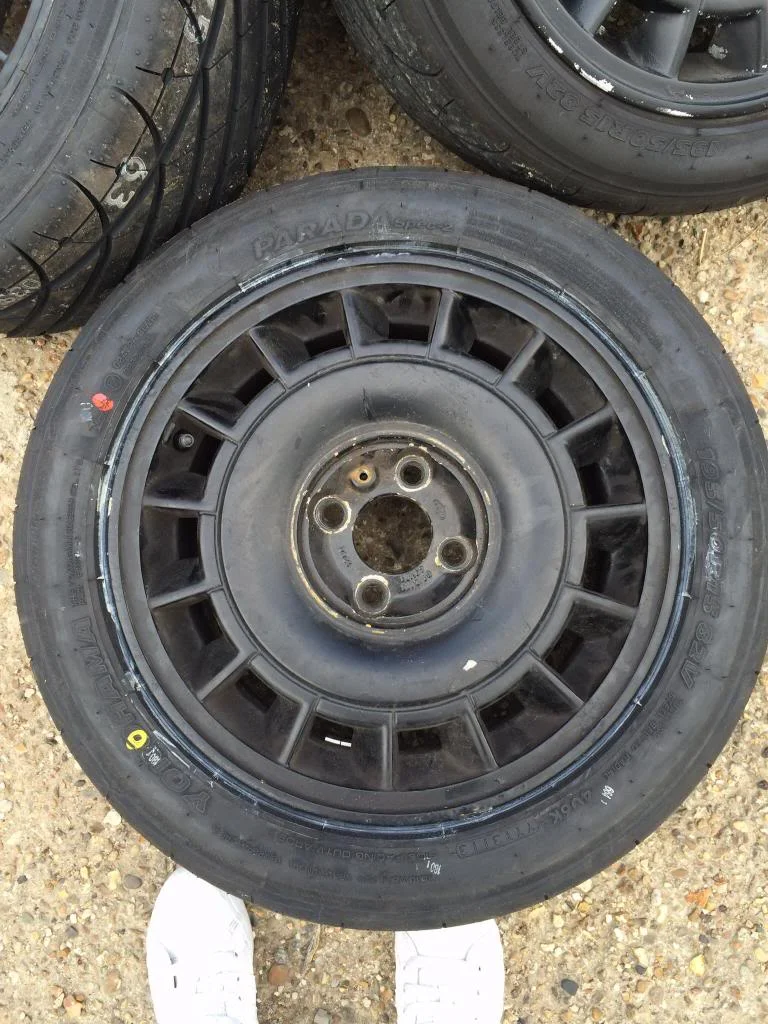

Haven't been on here in a while but here is what I have done to her so far:Turbines have been sprayed graphite grey with glitter in the lacquer. The wheels where badly painted with black rattle can which had reacted with the paint underneath, took a while to run down because they had been covered in layers of paint.

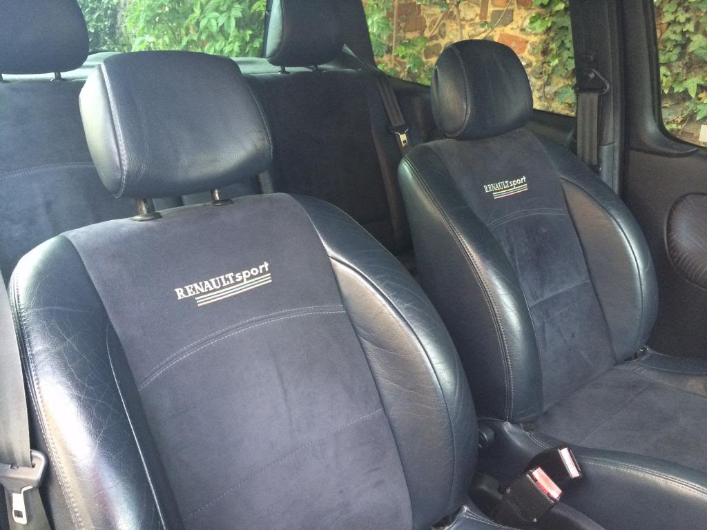

Replaced dynamic interior for phase 1 172 interior. It took most of the day to wire the seats in, and make sure the air bag and service light did not come on. Thanks to Dan Mallet for the seats and help with the wiring. Interior is in good condition but now need door cards:
New discs and pads and 2 new Yokohama prada spec 2 tyres ready for MOT but it failed on faulty hazard switch which is common from what I have heard and also the front left brake was binding on which was not good considering they had only been changed 2 days before the mot, so ordered a new hazard switch and took a look at the break which was bad because you couldn't spin the wheel at all, took the calliper off and pads to see if the piston had got stuck but hadn't so put it all back together and worked fine so 3 days later had an mot.
