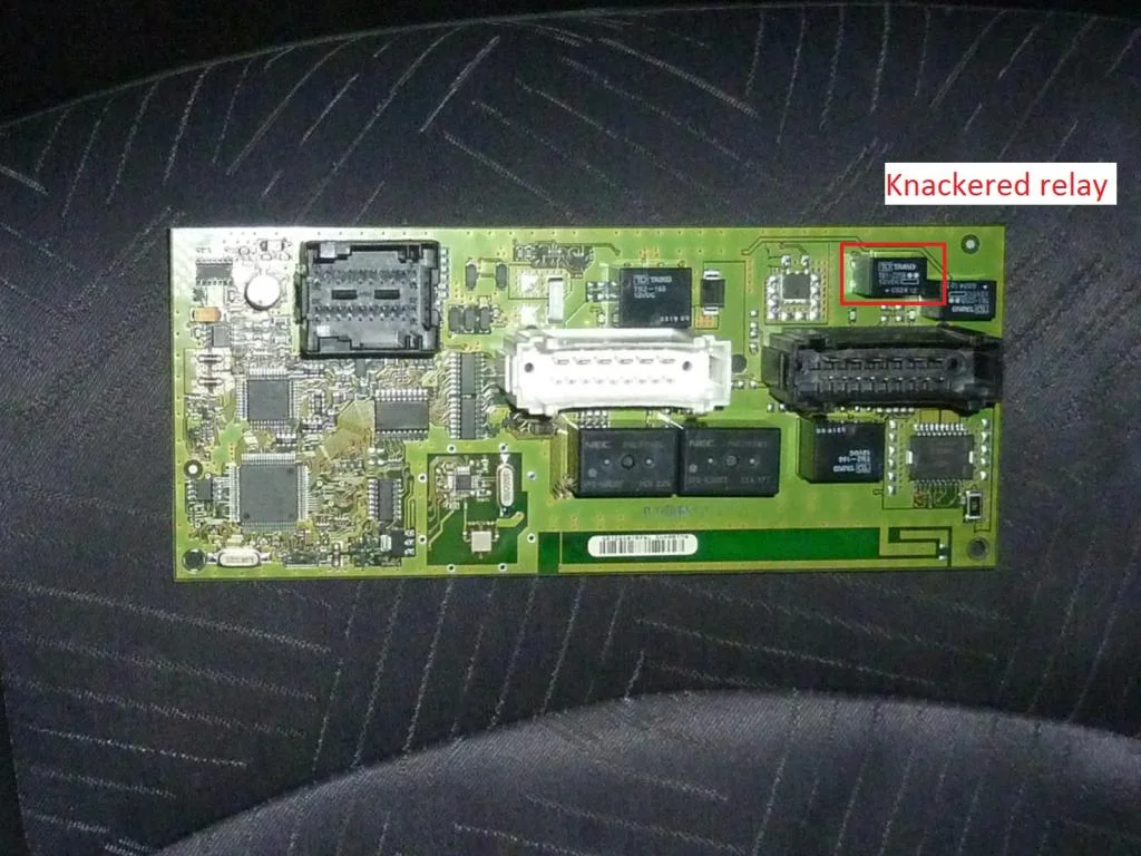

Right it looks like mine might be at fault with a blown relay. After much searching, it seems there are a few options. Renault seem to charge a bomb... so I could get mine repaired, or buy a second hand one.
Can you buy simply the UCH on it's own, if it's from another Clio 182 with the right code on it? It seems most of the sets on eBay etc. come with the ECU and other things which I don't need! Alternatively I could have a go at the repair myself, although I'm a bit worried about messing it up even further.

Hi mate, thanks for the advice but I think I'm having a different issue, this is what's related to mine...
http://www.cliosport.net/forum/show...2-UCH-investigation-solution&highlight=window
It's this relay that seems to go...
I was talking it over with a couple of electronics guys at work and they seem a bit dubious about it... willing to give it a go though if it saves me over £100.

That relay is through hole isn't it? That should be easier to change than a surface mount chip that is likely to be quite delicate, isn't it?

Good point I do actually have a remap on mine so don't want to be changing the ECU out... if I can't get hold of a UCH separately I'm still probably better off giving the relay bridge a go as it's 44p for a resistor compared to £140 lol.

Why do you want to bridge the relay? It's there for a reason. Replace it.

Well tbh I'm just going but this guys thread...
Specifically this section...
As far as I can surmise, the only function of the relay is for the one-touch function but as there's no one-touch activated on the passenger side, it's therefore redundant. As I said in the write-up, the feed is fused by the 30 amp window fuse at the fusebox and is a switched live anyway, so there is a suitable level of protection there already and the 30 amp fuse only serves the passenger side circuit anyway - the driver's side window is controlled by the UCH fuse in the centre of the fusebox.
It also seems very hard to get hold of the right replacement.

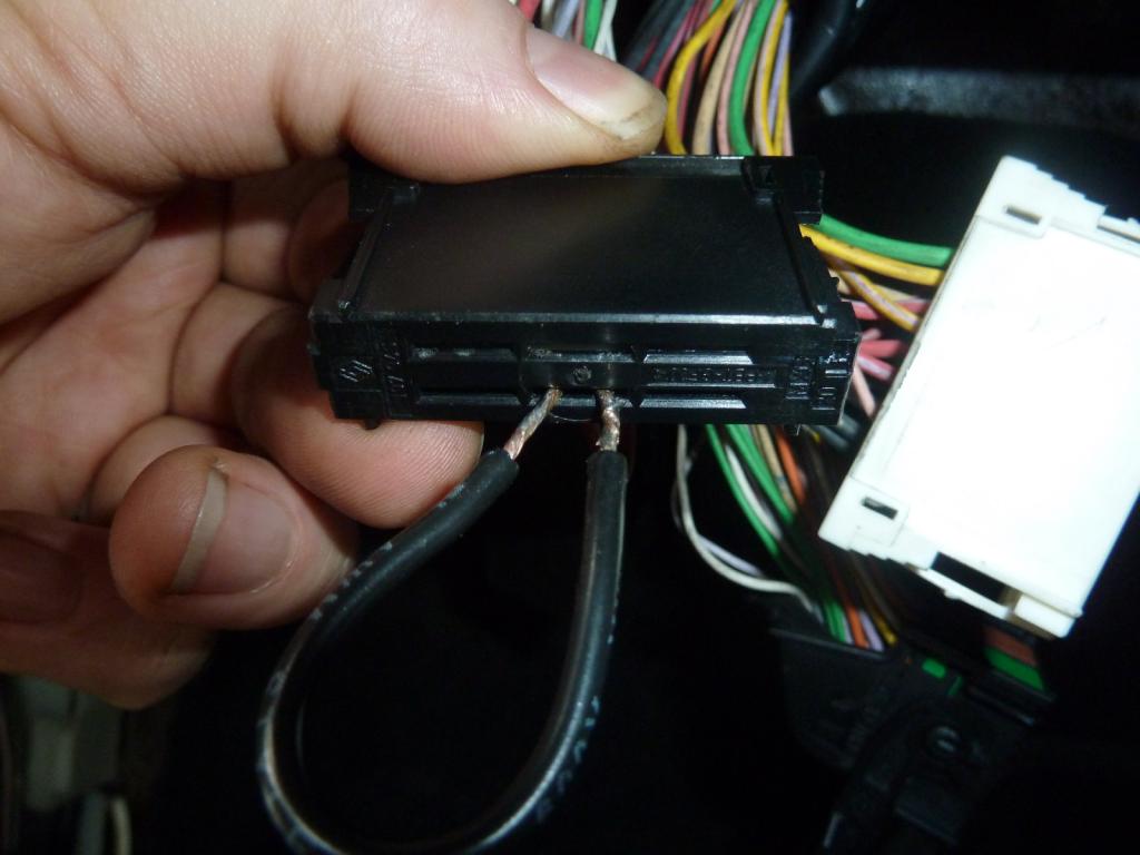

Almost at the end of my tether with this one! I tried doing the bridging test on the UCH connection as per...
UCH
Next it was time to bypass the UCH and test the window, so I bridged the Y/R and red wires at the connector with a length of wire. The feed to the UCH is both switched and fused, so this was a completely safe thing to do. Bingo! The window worked, well at least it went up and down, I’ll gloss over the fact that the regulator obviously needs a bit of investigation where it holds the window!
This highlighted that the UCH was to blame! Surprise surprise... so it was time to remove it and start working out what was going on.
However when bridged, my window still refused to move!? Also, I found it strange that I am supposedly getting no voltage at the window fuse despite the drivers side working perfectly. Any additional ideas? I'm beginning to admit defeat and take it to the garage :(
  Audi (R)S2, 1.6 16v
The driver's side runs off a separate circuit, so that'll explain why it works and the passenger side does not.
Have you supplied 12v directly to the window mech to prove it works?
