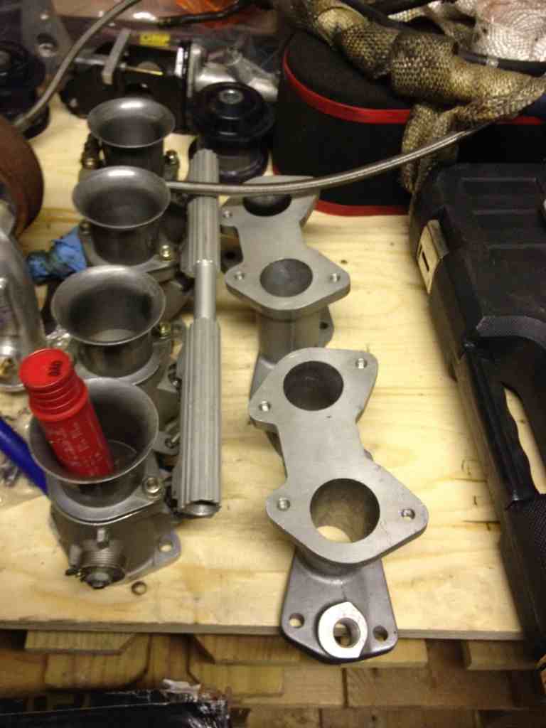

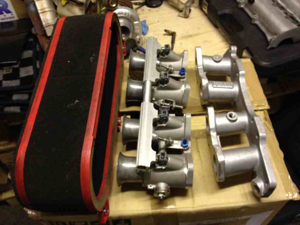

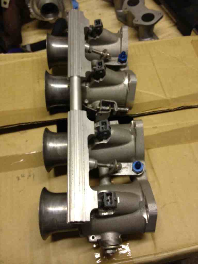

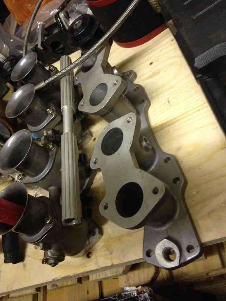

Hi, I recently brought a clio 172 (2002) which I am loving, I also picked up some throttle bodies with this buy for around £500 more (doing my research I found this was a good buy as once fitted i'm looking at 200+ BHP and they are sell for 800 used usually).
Has anyone fitted these before? If so do you know what is required? It's proving difficult to find solid information on the net. Any advice is greatly appreicated :)
Here are some pictures of the ITB's:
