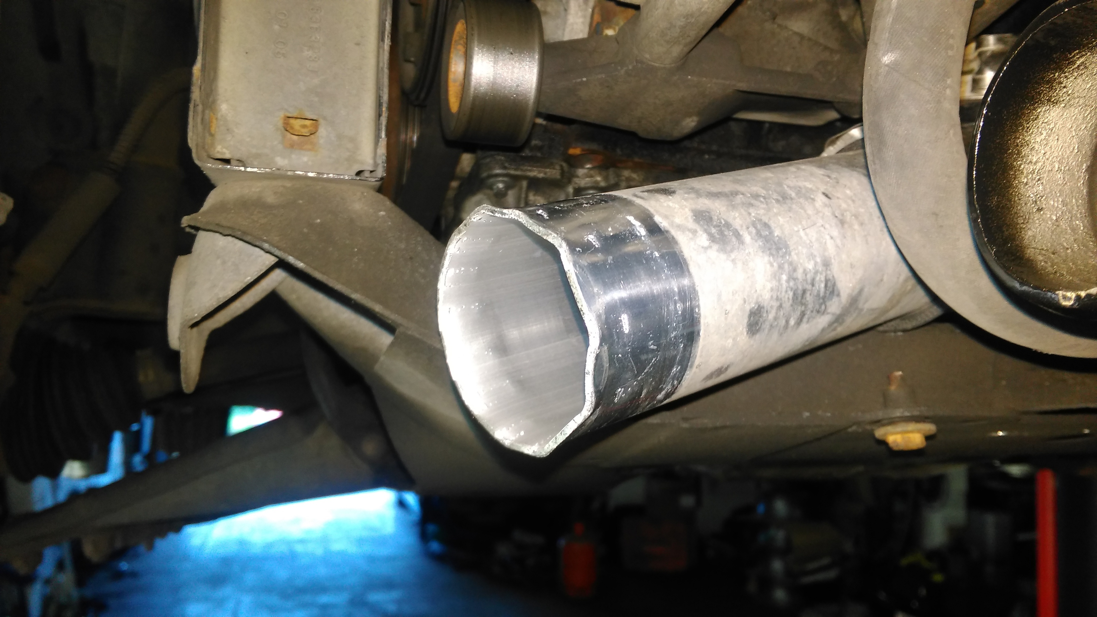

Banging from the downpipe hitting the subframe, I took it to Powerflow in Doncaster, they revealed that the downpipe was actually resting on the subframe, and that the gasket in the downpipe was too big and didn't fit and was squashed together when bolted up tight causing it to blow - full new poweflow exhaust now, sorted.

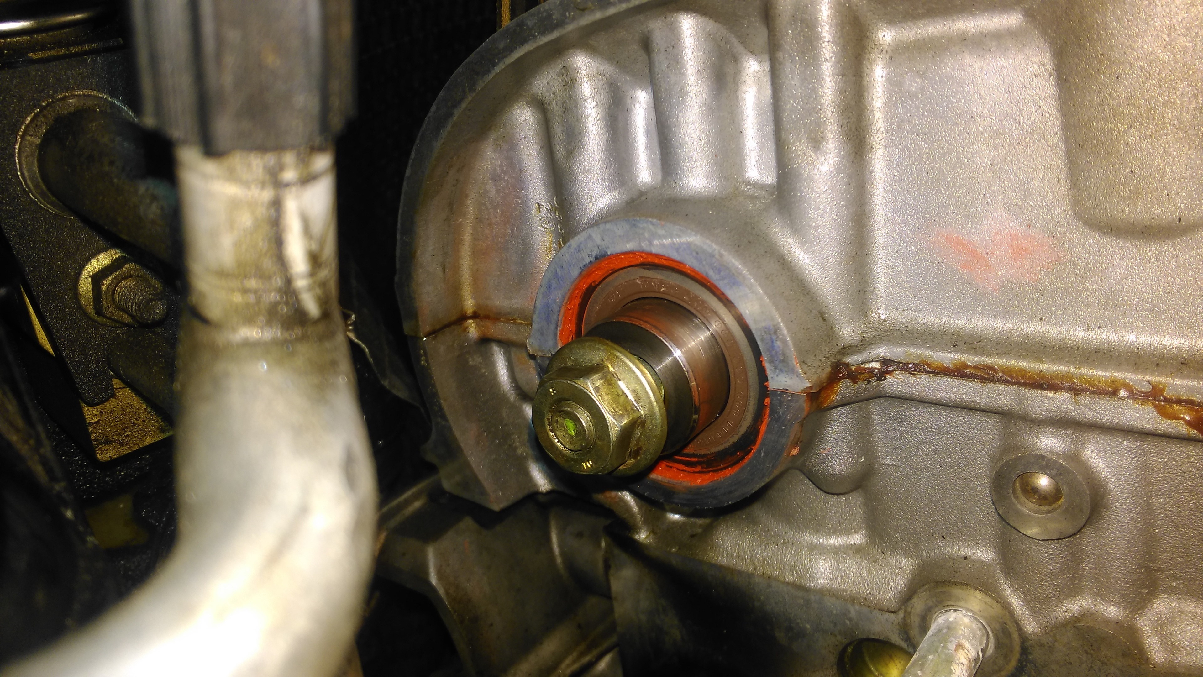

Cam seal popped out causing a massive oil leak(didn't realise until the missfire) causing engine damage - at Clioturbo in for repairs atm.
All this happened within 10 months of driving and 8k miles(no track days) iv had a few other problems but these are the main ones that I can remember.
