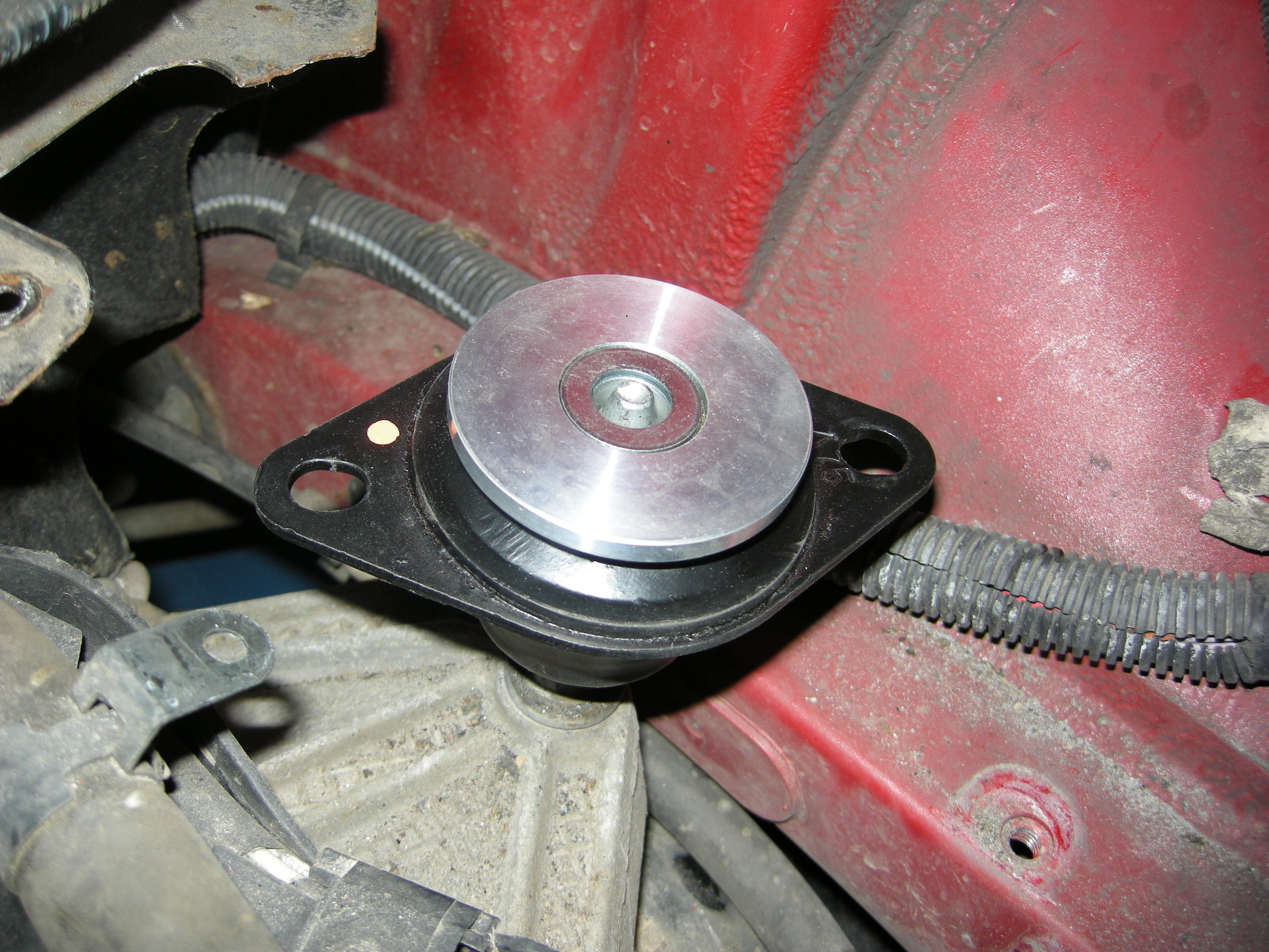

trouble fitting ktr / vibra gearbox mount
  182T

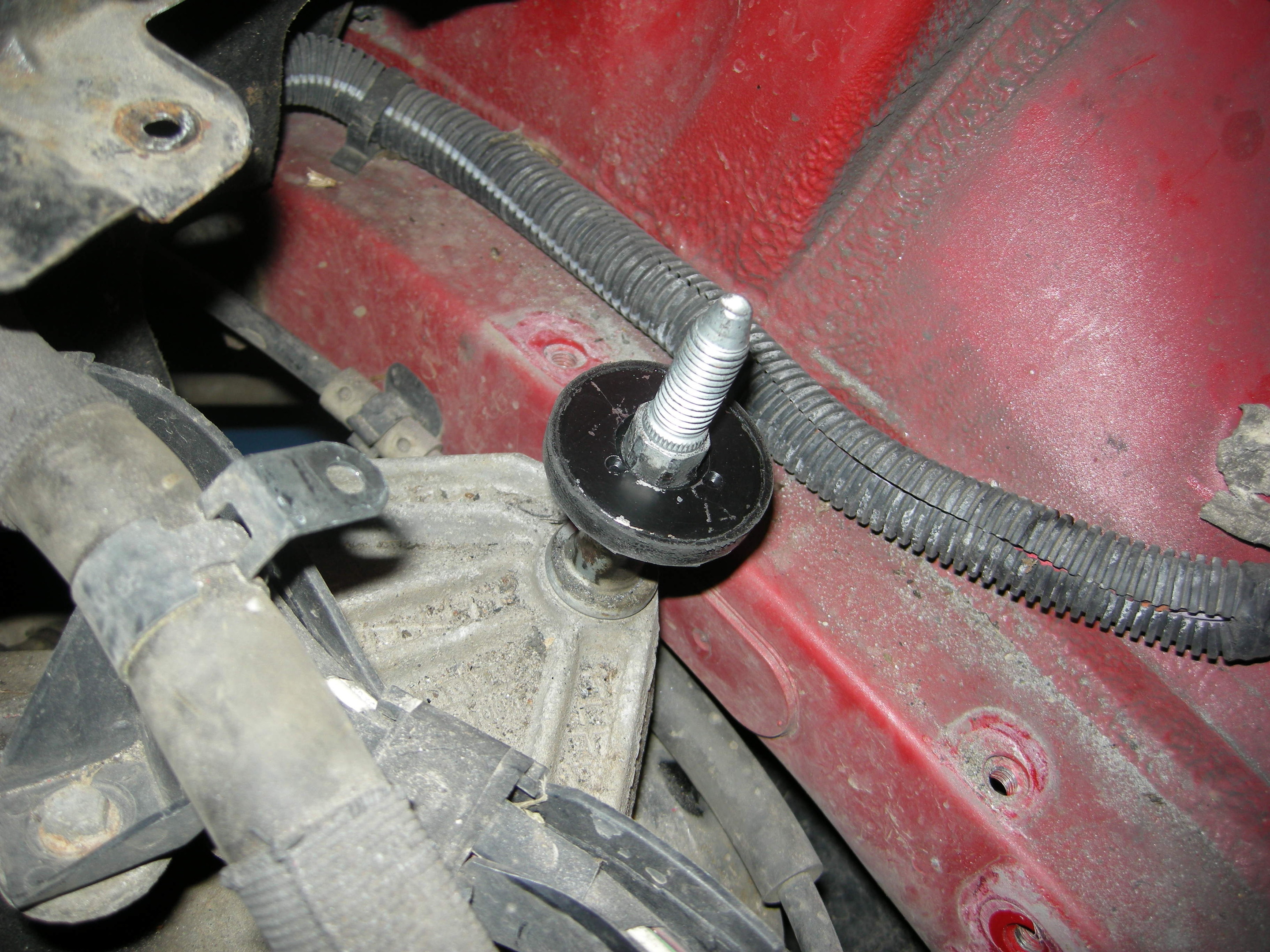

For anyone who has fitted one - I can't seem to get the mount far enough down the spigot/shaft for it to protrude and get the nut on. The mount parts go over the thread but not the main shaft body. (tray removed for clarity)
Any suggestions?

I fitted mine recently and had to very slightly enlarge the hole in the new mount to fit over the spindle. I used a dremel and had to take very little off it. I know you shouldn't have to do this - but I did read about someone else having the same problem.
  182T
markoc - was that on both the metal/rubber ring part in the first pic and also the main mount body? Did you get the ring (first pic) to sit flush on the base where the spindle meets the 'tripod' part of the gearbox bracket? thanks for your help.

a few minutes with a round file and it was on. A fair bit of vibration, I'll re-seat them at some point. I was also a little concerned about losing the square nut that helps locate the engine mount on the new spindle but k-tec told me it should be fine - so we'll see.

Didn't touch the spindle, just filed out the hole in the bush and also through the center of the mount - the mount took a little more filing than the bush.

tap it down, it doesn't need to come off. I spent an age trying to get it off, then realiased it just needs tapping down over the spindle

Could just take the mount off completely and then tap the spindle out

anyways.... my version of the upper gearbox mount guide
put car on stands, place jack under gearbox but do not raise it, loosen middle 18mm nut and the two 13mm mount nuts, do not take out
jack box up, remove all the bolts and nuts, fit bearing puller in, a bit fiddly but it came out without much force
filed the bottom rubber bit a little, went right in, took a while to file the metal bit inside the bushing cause it couldn't clear the gearbox mount bolt hex bit...tighten the new middle nut (19mm) and mount bolts/nuts (13mm), use your fingers to hold down the nut, once you reach a certain point, the bracket has some edges on the side to hold the 13mm nut in place so just tighten the bolt, success:smiley:
note: loosen and move ecu bracket a bit for more space for fit hand and put the top nut on, i dropped the nut and took an hour to find it, it ended up being inside the subframe between the wishbone mounting points
