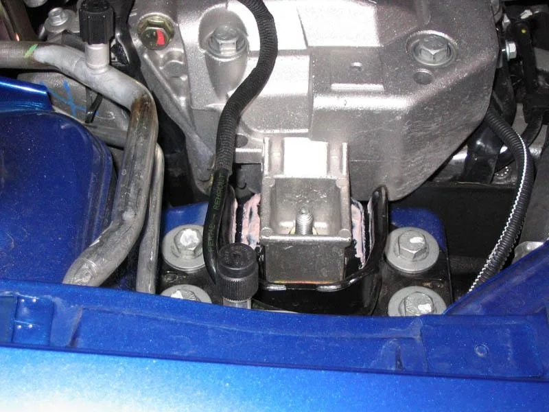

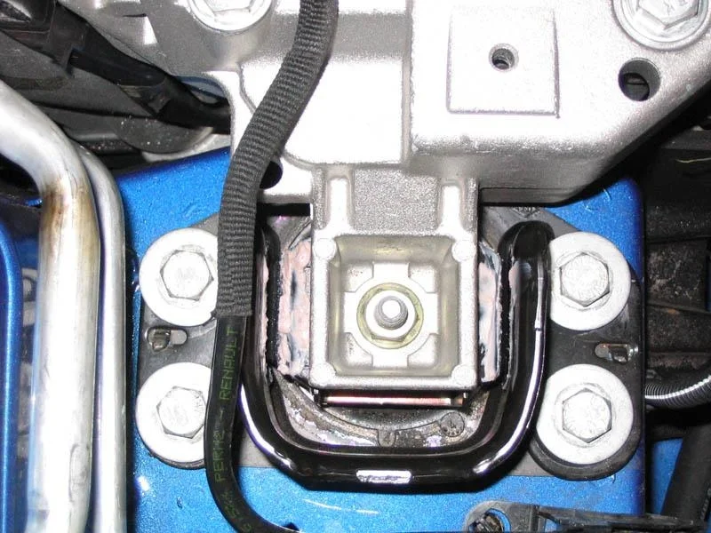

I'll put money on them not having the mount in stock, meaning they'll have to book you in again Nige. That's what they did to mine. When I had it done on the 182 they did a bodge which fixed it for good. That was done by Sutton Park though, not Renault Brum.

Thanks for that Lee, I can't quite make out what the mod is that Renault carried out in the pictures. I'll print them out and go and compare to mine when the rain stops.

On my 182 they just straightened them up and packed them with white goo. I told Renault Birmingham about that and they were going to do the same. Unfortunately they had to replace the mount this time.
