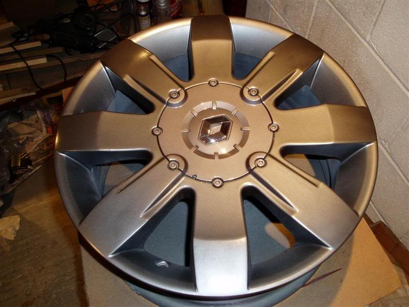

This is Rover Stone grey , nearest match i could find . Even then , the guy who mixed it had to tweak it slightly by adding a bit of extra red to make it a perfect match .

^ was one of the first to start playing with rover stone grey (back in 04) and im pleased with the match and im a fussy sod! ;)
i agree with above post!
  E46 325ci, ZX10r E9f
wheel on the car is oe colour, other wheel has been done by me in rover stone grey, it is a shade darker
