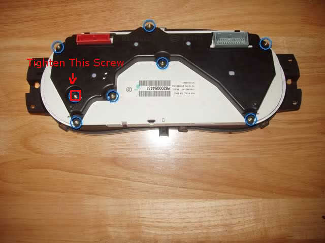

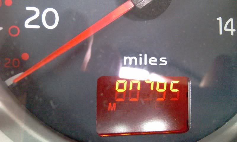

I've posted about this problem before but I have only just taken my dash off and taken a look to try and fix it. Basically my trip display which shows mileage, mpg...etc has a slight fault in the display (See below). Does anybody know what this could be? I have tried tightening the screw behind incase it was a loose connection but that didn't fix it, (Cheers JohnOR for the suggestion) and I've taken my clock apart to look at the SMD's but replacing them is a last resort. Anyone have any suggestions whilst I still have my dash off? Cheers!

as you can see the top part of the display then its not going to be an smd fault as the lights are clearly working and there is only one row of smd's neway so if it was them it would be all or nothing. i think its more a fault with the display. i had this exact fault on my 1.2. i ended up buying another set of dials with similar mileage and just replaced them. £30 - £40 and the problem goes away, might be easier than wasting more time and energy stressing about it and trying to get to the bottom of it. just plug and play, sorted.

actually looking at tat 2nd pic again you can just make out the bottom half of the mileage, mine dissapeared fully, you may be right in thinking something is loose then. take it apart and make sure everything is pushed together.

Looks like it might be the display, the bottom half cant quite make up it's mind. They slot out after there taken apart if I can remember back to the last set of dial's I butchered!

I fixed this today, for those who would like to attempt it, it may work for you I'm not sure what I actually did but try it anyway...
Take clocks apart by following the LED conversion guide.
Peel back the vinyl(?) which is stuck down with some sort of adhesive, don't worry it easily sticks back down without bubbles/creases/additional adhesive.
Turn it over and pop out the snap fits on the black part.
The LCD should come out easily from underneath the vinyl.
I just gave it a clean with a dry cloth, looked at it in the light to remove any obvious 'smudges' or defects. Ensured everything looked fine and put it back in by reversing the above steps.
Not sure if this helps anyone but I may as well put it on here on than not...
