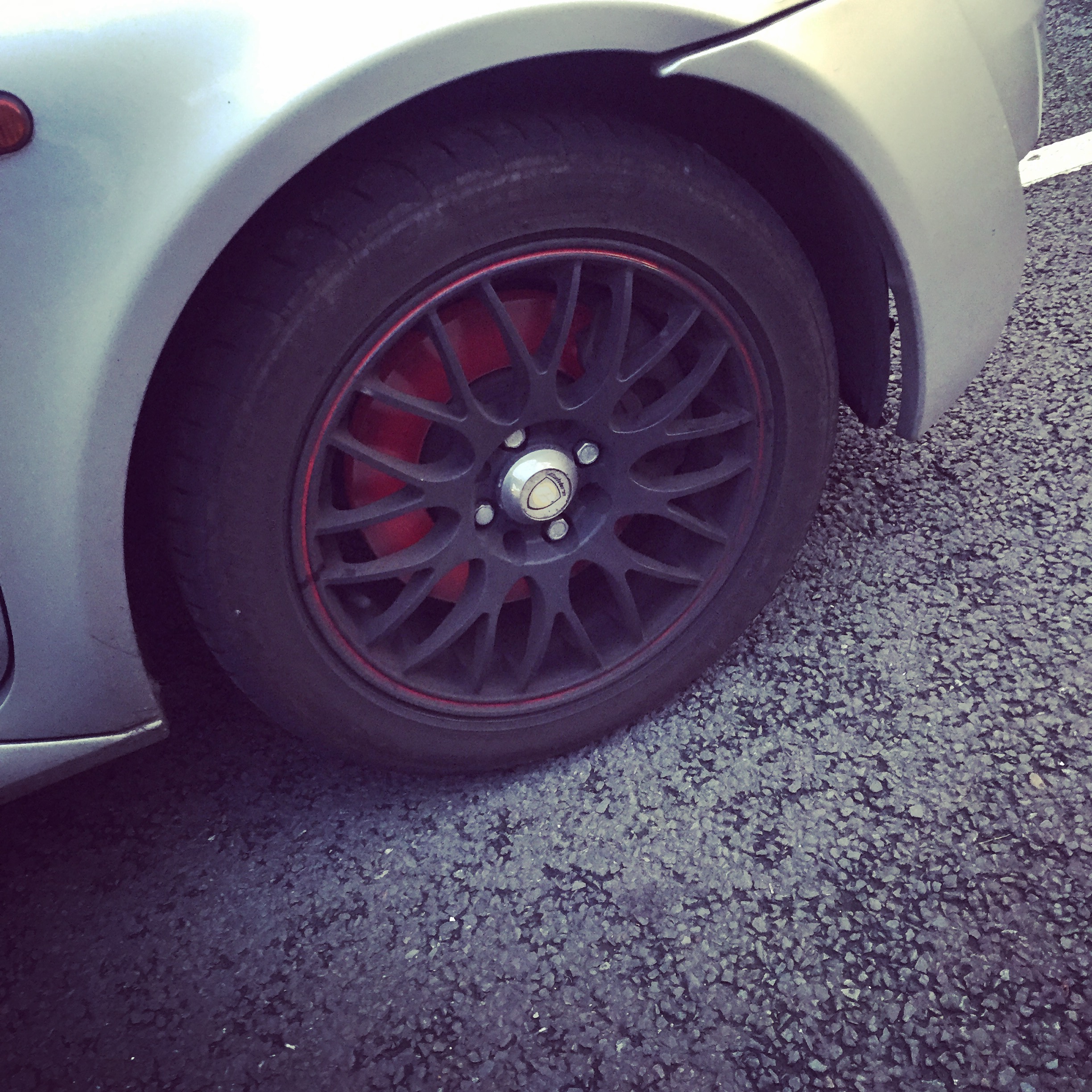

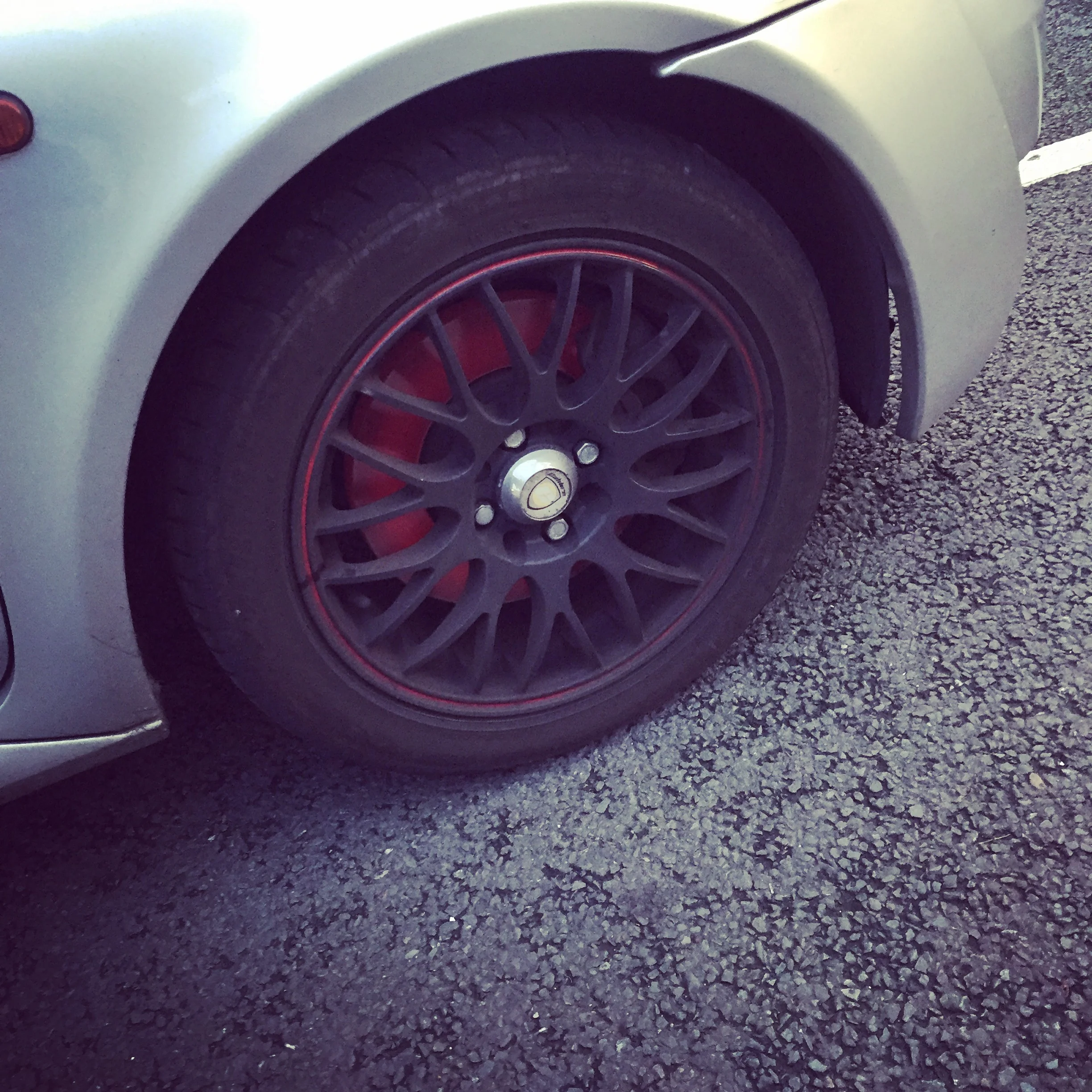

I'm running DS2500 with HC Brembo discs and superblue (well, gold now!) fluid. It's an everyday smoke with occasional trackdays.
Quite hard on brakes and they didn't even think of fading even when glowing!
