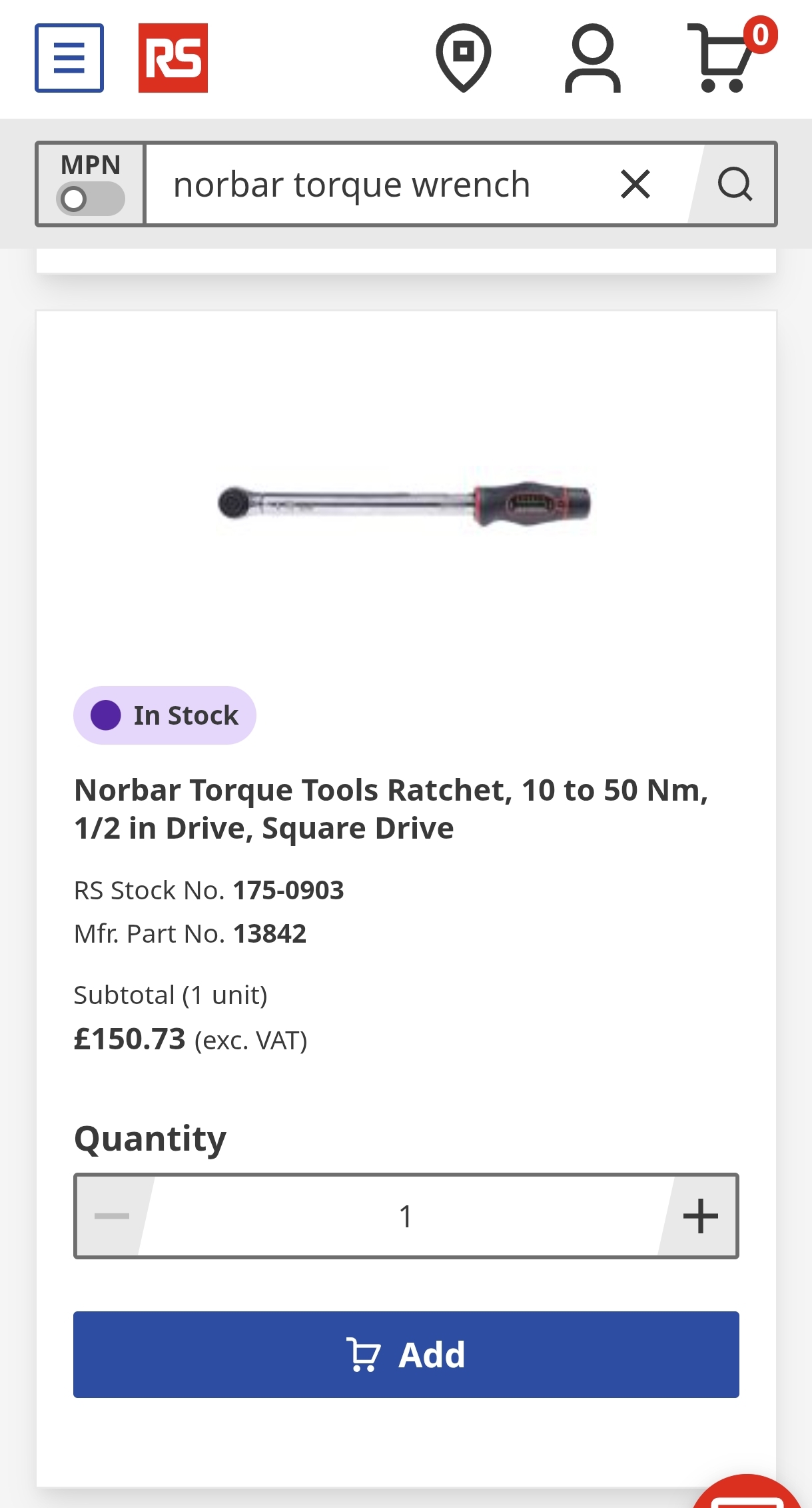

MAXRUNDOWN
Another vote for norbar, I use them at work and have a set at home, these will cover everything you need to do and last a lifetime
Clio_fool
I've got a 20-100 norbar one thats 27 years old now! Used it today and it's still bang on. I've also got a silver line one off amazon for the bigger numbers which is pleasingly solid considering the price.
