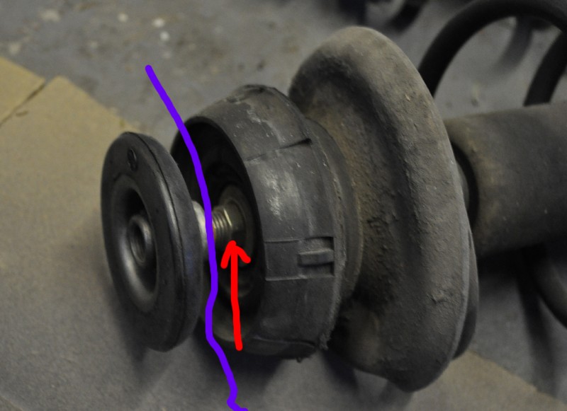

Sam i dont know who held your springs compressed but i cant get anyone to hold them down enough, need wait for the gf get back so she can go fetch me some spring compressors!!!! lol
  DCi 100
The red nut is the only thing holding the spring from flying down your street while it's off the car soo.. don't be undoing that one in a rush! Blue is obviously where the body work sits. Hope the pic helps you.
