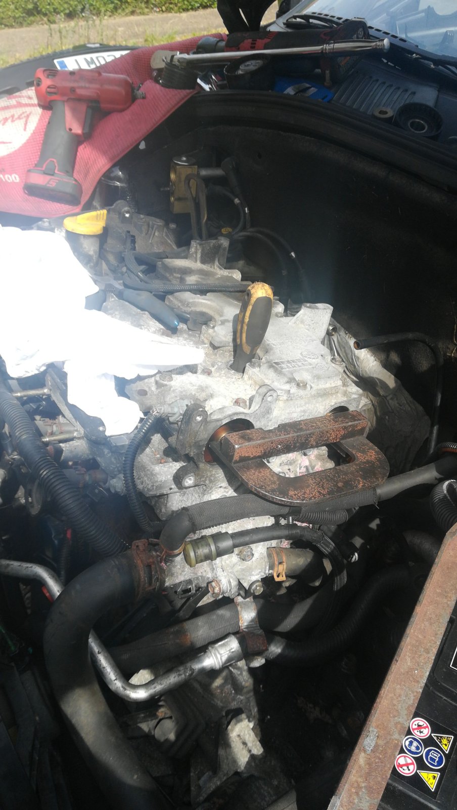

One of my customers ended up in the gravel on a track session and his car started to run like crap. He carried on despite the spluttering and poor performance.
By time he got home the car barely ran.
Here's what I found

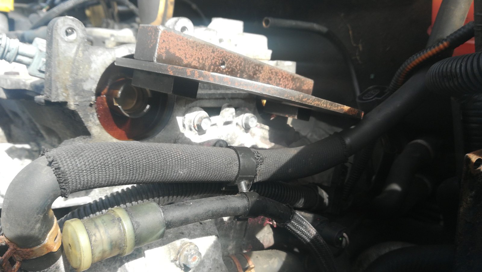

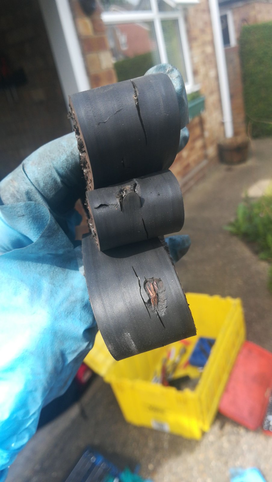

(Stone had got into the timing belt cover and danced with the sprockets)
Timing was out on both cams by roughly 20degrees .
If you hit the gravel and stall best to wait for recovery.
Fortunately new belt kits and retimed no serious damage done.
