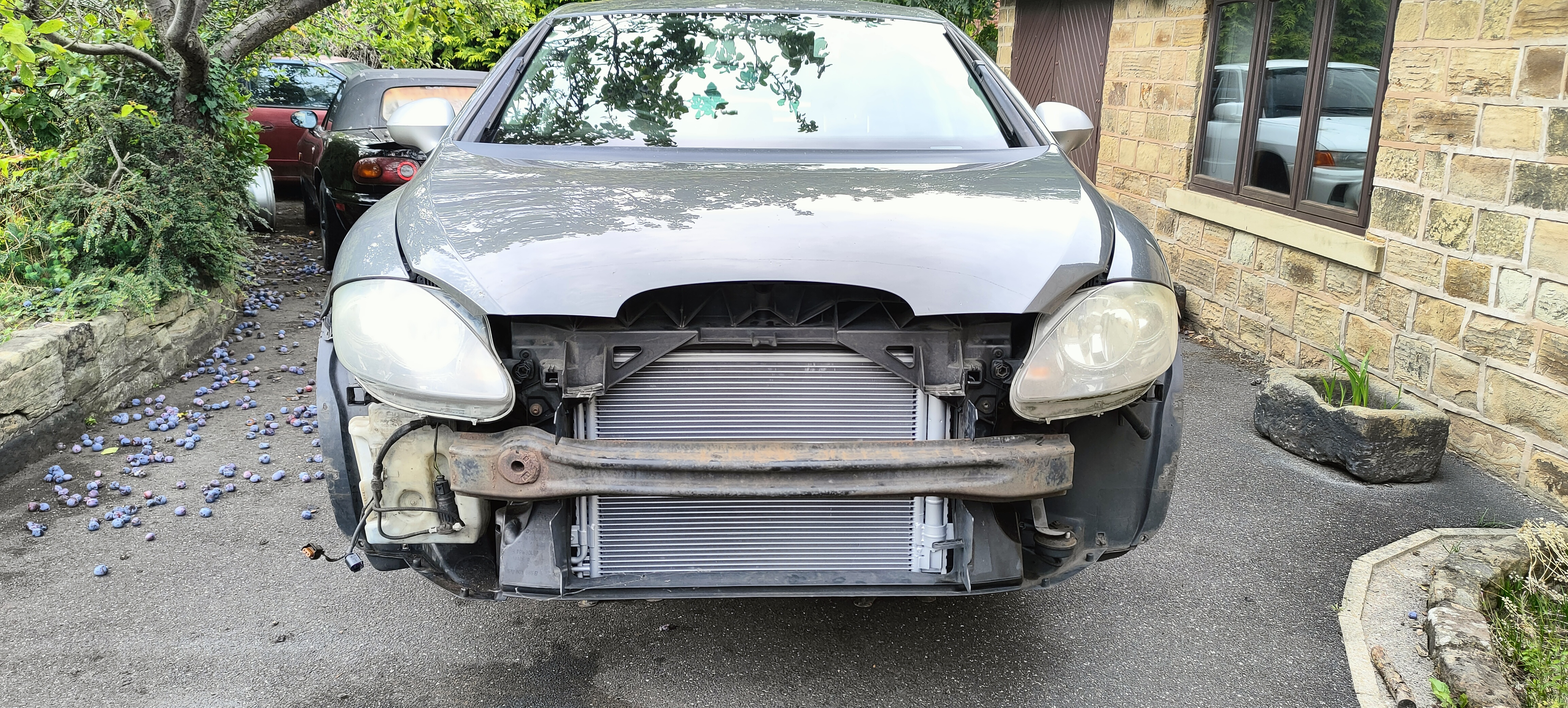

Have just replaced the AC compressor and condenser on my Leon (Mk6 Golf platform)
What now? Do I have to inject oil into the compressor? Can I drive it to a place to get the AC charged, will they have the PAG oil?
Also, f**k this job. What a total pain in the bum!

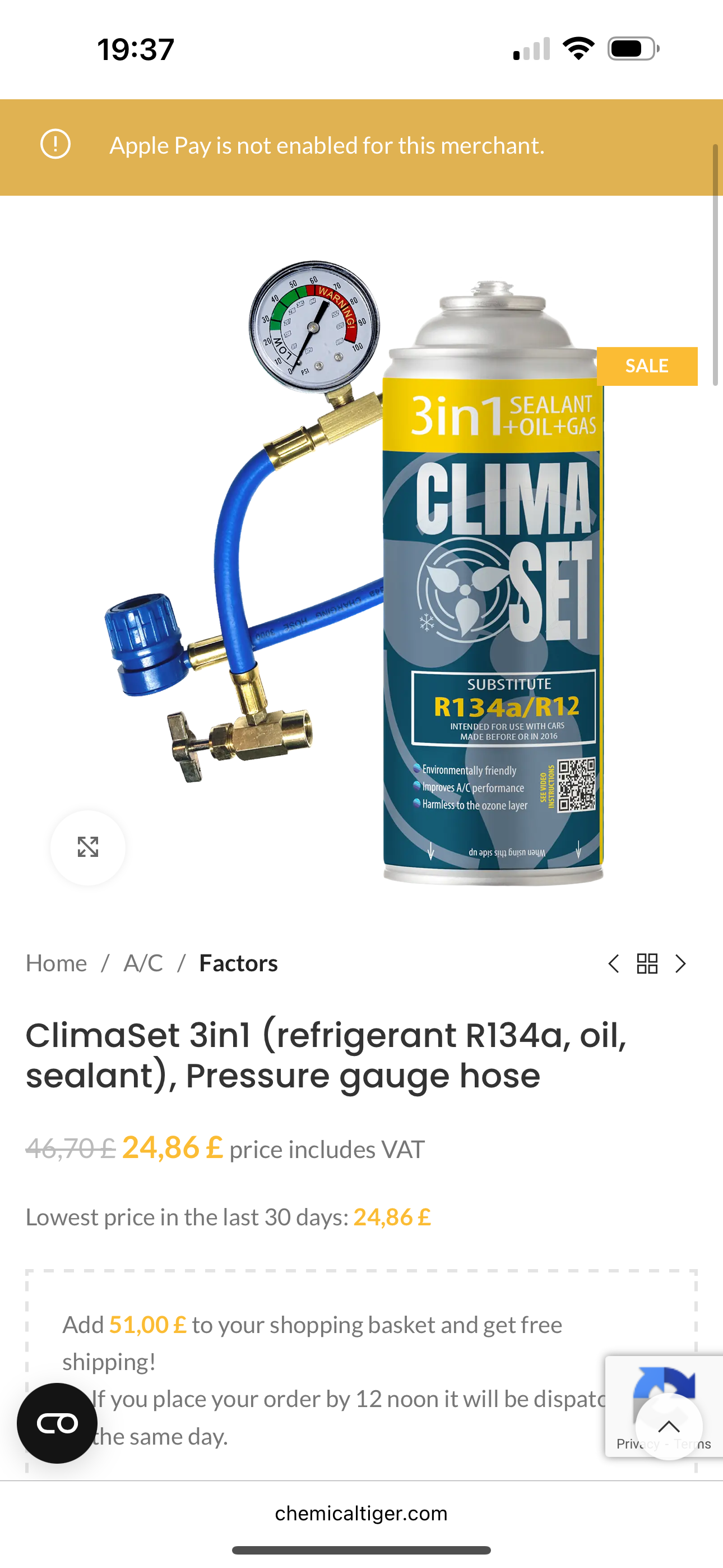

Can you use one of these kits which has gas, oil and sealant till you get it to a garage?
R3k1355
Yea I've got the filling kit and the can's are not expensive, are they ok to fill a system from empty? They only connect to the low pressure side of the system.
or does it need a professional kit because it's completely empty?
No local mobile regas people round your way that would be less hassle.
@Scrooge knows about this stuff but I've always been of the understanding that to properly fill the system you need to vac it first which also removes any moisture.
I accidentally turned my Clio ac pump upside-down when it was off the car and poured all the oil out, I bought PAG oil and refilled it however there was really no spec on line (that i could find) telling you how much oil to put in so I guessed, I also didn't think the proper garage style refill systems added oil?
Anyway, Scrooge will know and won't be just making stuff up like me.
Scrooge
  E55 AMG
Always use a proper machine with a proper set of gauges imo.
If it’s empty it needs a vacuum etc I also like to fill with nitrogen first as sometimes systems leak and don’t show on vacuum etc
You also usually need something like a Maxidas to double check pressures and make sure everything is working correctly. Mobile Ac. Guys tend to have these
The can are a false economy

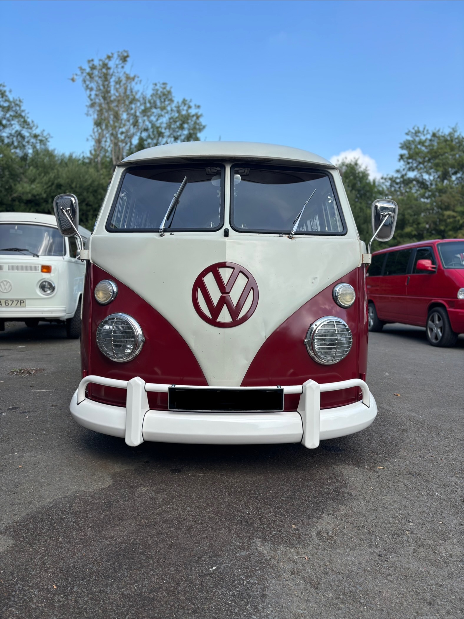

View attachment 1753166View attachment 1753167View attachment 1753169
American EZ conversion. 1600 on twin carbs with a nice interior conversion. Slightly lowered on replica wheels. Has later braking system with discs up front. Bottom of the pile for Splitscreen officianos and with plenty of patina but one I/we can use and for once a vehicle the Mrs approves of!
Nice one!! Is it LHD or RHD? (can I work this out from the position of the wipers?)
I've always wanted one.

@cat171 Thanks. It’s a German van that would have been imported new to America so is LHD. It came to the UK in 2012. Fingers crossed we should be getting it next week 🤞
