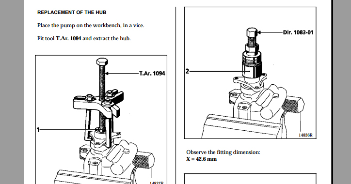

Seeing as my other existing thread has gone quiet, does anyone know what I need to do to the new pump before I can fit it? pull the pulley off using a puller? any special method? then can I use the vice to press it back or or is there a hose at the back that cant be pressed in a vice?

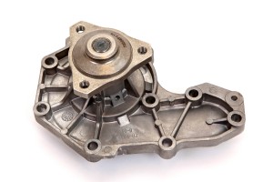

No need for a puller to take the pulley off the water pump. Just undo the 3x 10mm bolts that hold it on and it'll fall off.
Yeah I had the pulley off for more room when taking the water pump off, but Im reading about this "boss" or "flange that needs to be pressed on and can be a right pain?
I thought the shaft that the pulley attaches too needs to be pulled off? saids something like that in the workshop manuals.

If the new unit is like the below, you should just have to fit the pulley with the 3 bolts.

Mate the problem seems to lye with the PAS pump now, the workshop manuals show the pulley shaft needing to be pulled off and pressed on ?
