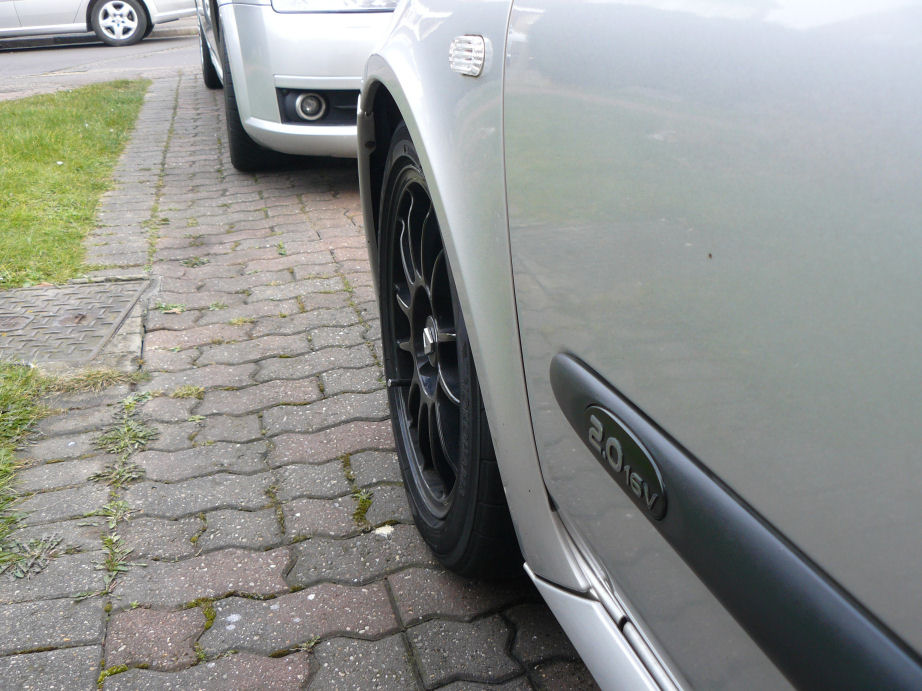

And here's a pic showing why I want spacers:
