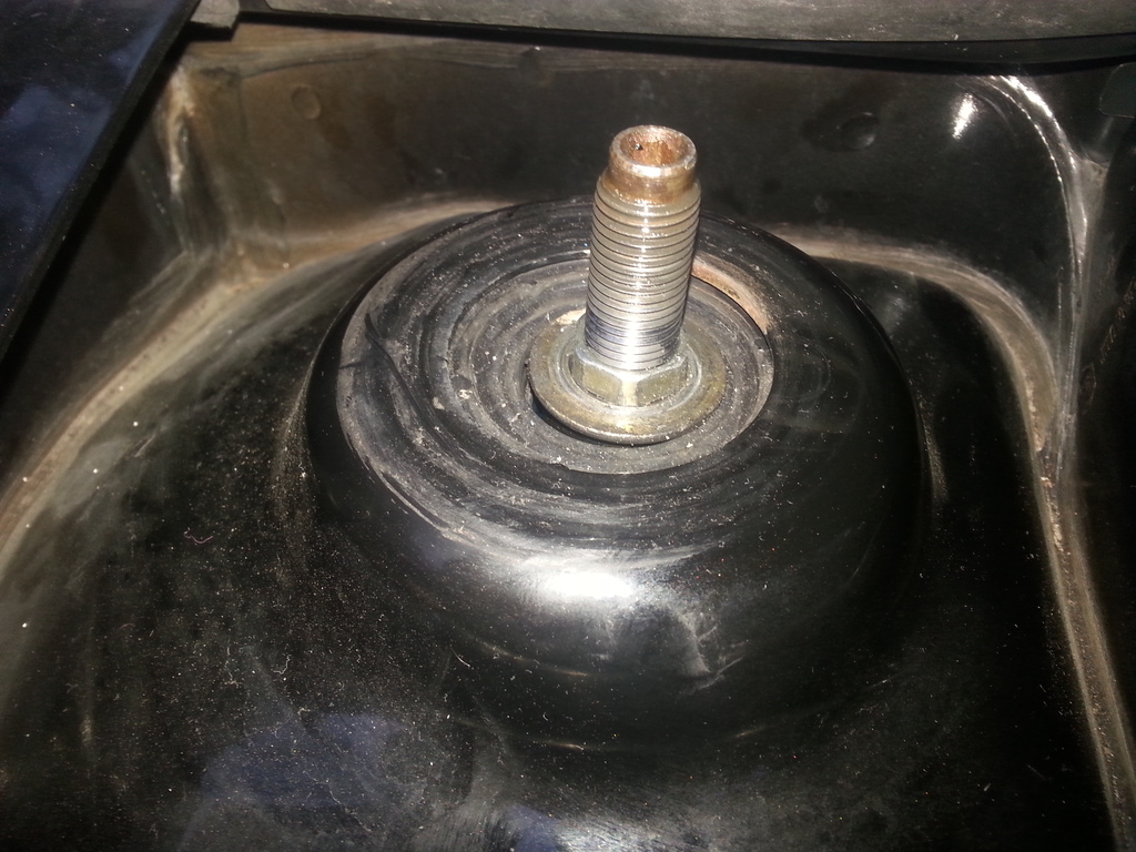

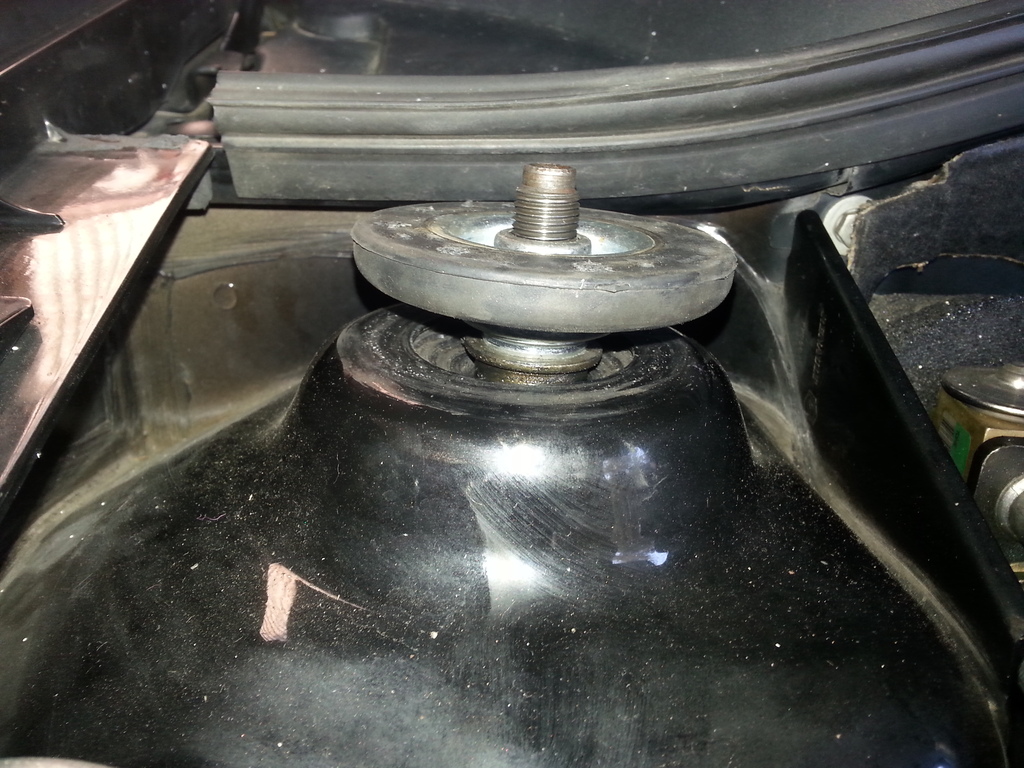

I tried solving a knocking noise by changing the top mount of the driver side suspension, but I think i have done somethin wrong as there is a big gap between the top hat and the body.
Side with no Knocking:
New Item and still knocking:
The diference is pretty obvious. I have taken it apart both sides to compare and they look the same next to each other. I have to say the new item is not OEM but MAPCO and that I have reused the sleve and nut and have not used the new updated design by renault as my other side has the old one and there is no knocking. Also there is a gap between the body and the rubber "doughnut" in the old one and there is no gap on the new one. I would appleciate some help on this as I am not driving the car until this is solved.
Thanks in advance
looks like the bearing is missing to me :/
Order should be... Top spring plate, bearing, rubber donut, spacer, skinny nut.
Thanks, why do you say that the bearing is missing? any indication for that?. I am sure that I have not missed the bearing, but I might have put it the wrong way round, but seems unlikely as I did both sides at the same time
if the bearing wasn't there the rubber donut would be sitting on the upper spring plate, which would push the spacer 8-10mm up through the donut (as can be seen in your pic).
It would also cause knocking when turning as the spring will be bouncing around in the spring plate, as it won't be able to turn freely without the bearing.
  172 Ph1/Scooby MY00

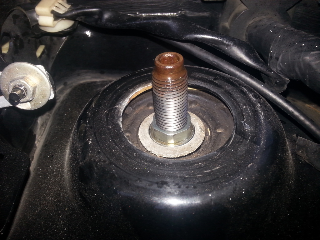

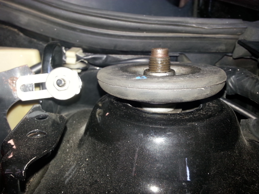

Ok, I get it, but it was not that. I took the suspension out again and check it, and the bearing was there. The problem is that the doughnut that mapco provided was really weaker than the renault one and as such the doughnut was touching the body
as opose to the other one:
I change the doughnut back to the original renault one and the height problem has been solved, but the knocking is still there unfortunatelly... Any ideas? it is only when going over bumps...
