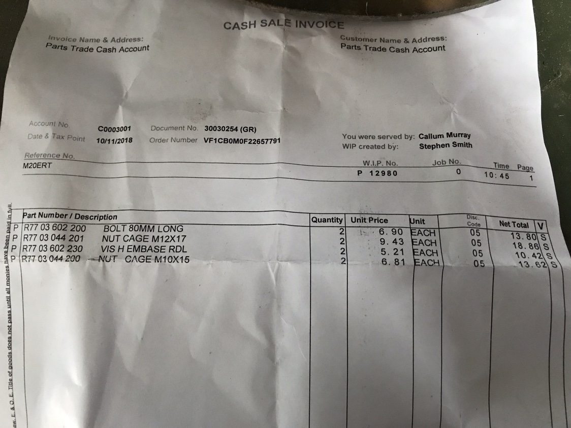

Got all part numbers here for bolts, nuts and cages. Comes in at around £70

3 out of 4 of mine were ok just last month and that was on a 120k mile Ph1, thought if I put on fresh ones with some copper grease they would be ok for a fair while
Apologies, cant find the photo I had of the part numbers anywhere
Mertin
  Ph1 172&Ph2 172 Cup
Sorted! £68 in total
