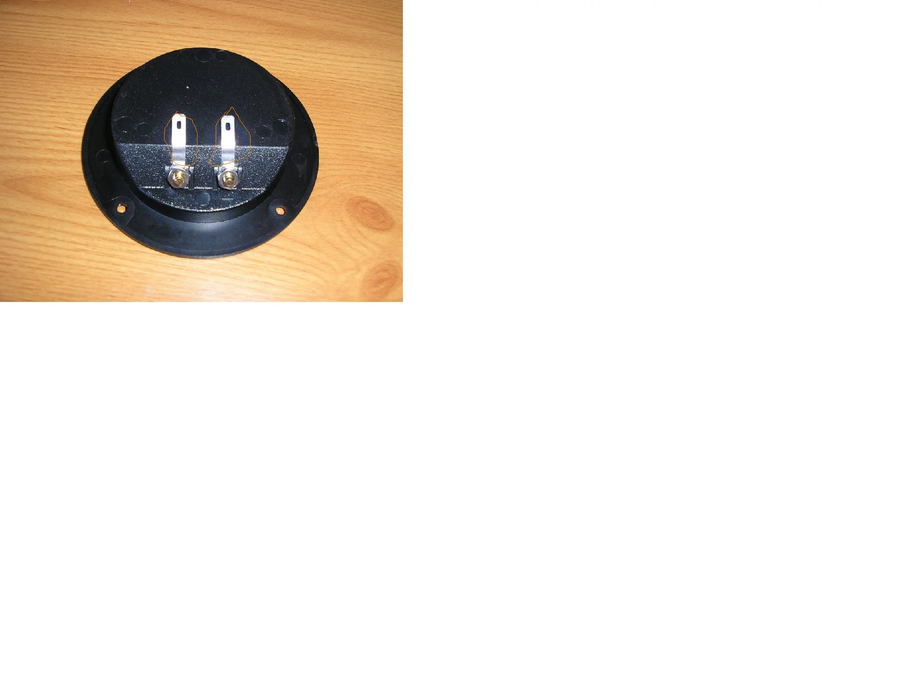

few pics of my terminal..

also i'd remove the tabs shown in pic below and use crimped ring lugs on the nuts to give a decent connection
