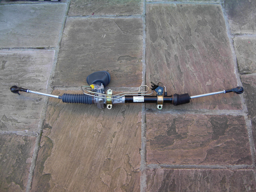

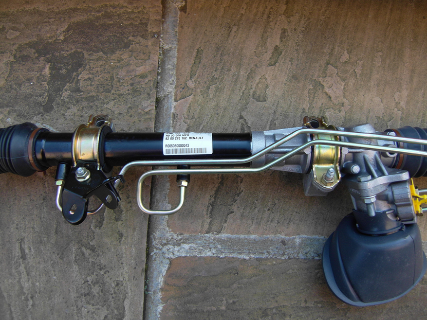

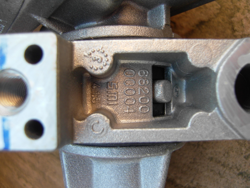

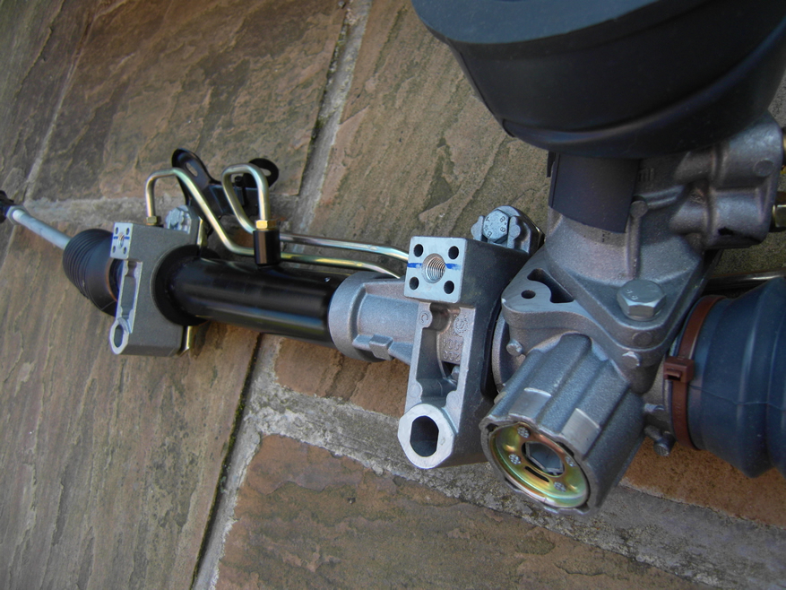

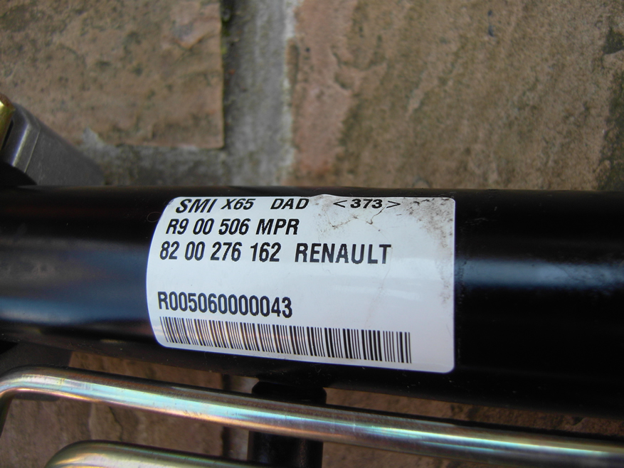

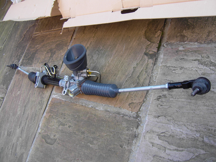

SMI Rack has a sticker on it like this:
Also has other stamps, but you wont be able to see them while its on the car.
  172, VX220t, Westfield se
Thanks for quick replies. It hasn't got a sticker, but I guess that probably would have come off years ago.
Jon, have you got any more photos of the SMI rack please? If you have it would be good to see them and see if it looks the same as the one on my car.
If not I'll just go for the SMI ones as per Chips advice.

Thanks for the photos Jon and to Fred for confirming. I'll get the mounts ordered tomorrow.
The steering isn't as direct as it should be and on inspection the rack is moving a few mm, so i'm looking forward to getting the new mounts on and get the car driving as it should again.
