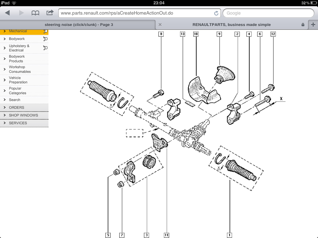

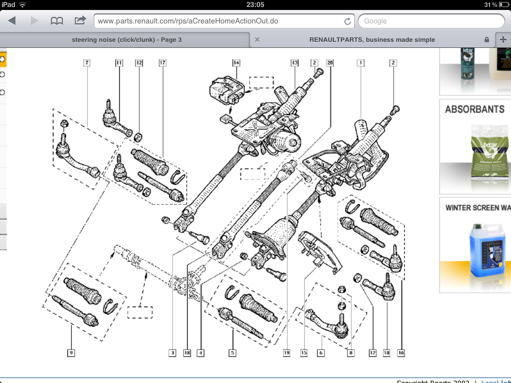

I just wanna get my car in the garage now! Wanna see what it is lol I've got some vibratechnics engine mounts coming on Sunday now aswell so if it is down to them I've got that covered. I think it is something to do with the rack tho, as it's bolted to the subframe. But will have to see.
  Arctic 182, GTD
Only two pics I could get quick. Not a lot to the steering tbh.lol
  Arctic 182, GTD
Haha. Obv the pics show the different variants to the steering but that's alright. Got my car in tomorrow to try and find this clunk so hopefully it'll get sorted! Haha
