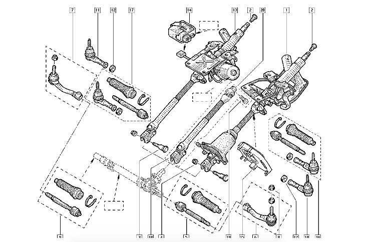

Does anybody have a photo of a column without this massive bracket/housing on? I've googled and googled and all have the big bracket on.

Is the bearing meant to be attached to the column or the big adjustable bracket that comes off it in the top of the collar?
Without having a good one and a fucked one sat side by side I can't say mate. @MarcR™ may be able to post up an image of the steering column off the parts system though? This may help to see it slightly clearer.

Hi Marc
Ph2 172 LD02 BPV if any help
Taken from a rack which is a SMI rack

Interesting, so I'm guessing I shouldn't of been able to pull that whole bracket off of the rack, but could because bearing was bust.
I'll get a whole, new column then, I thought I could just swap the big bulky bit.
