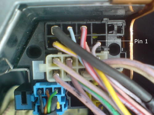

Boosta,
You can just see the yellow connector hiding behind the wires on the right of this pic, the blue one is the disc changer connection, the yellow one is similar in size, just one row of pins shorter.
  Cliosport 172
oh dear must be broken then because i've got the yellow connector plugged in, i thought it was the blue one as i don't have a changer:(
