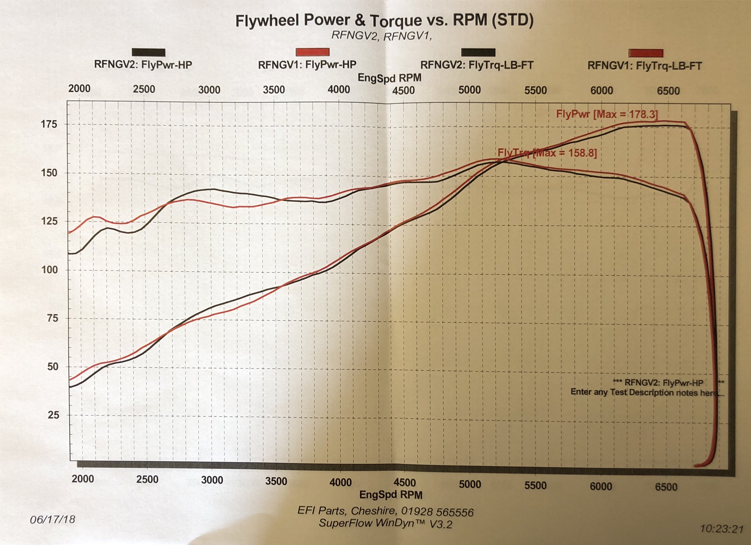

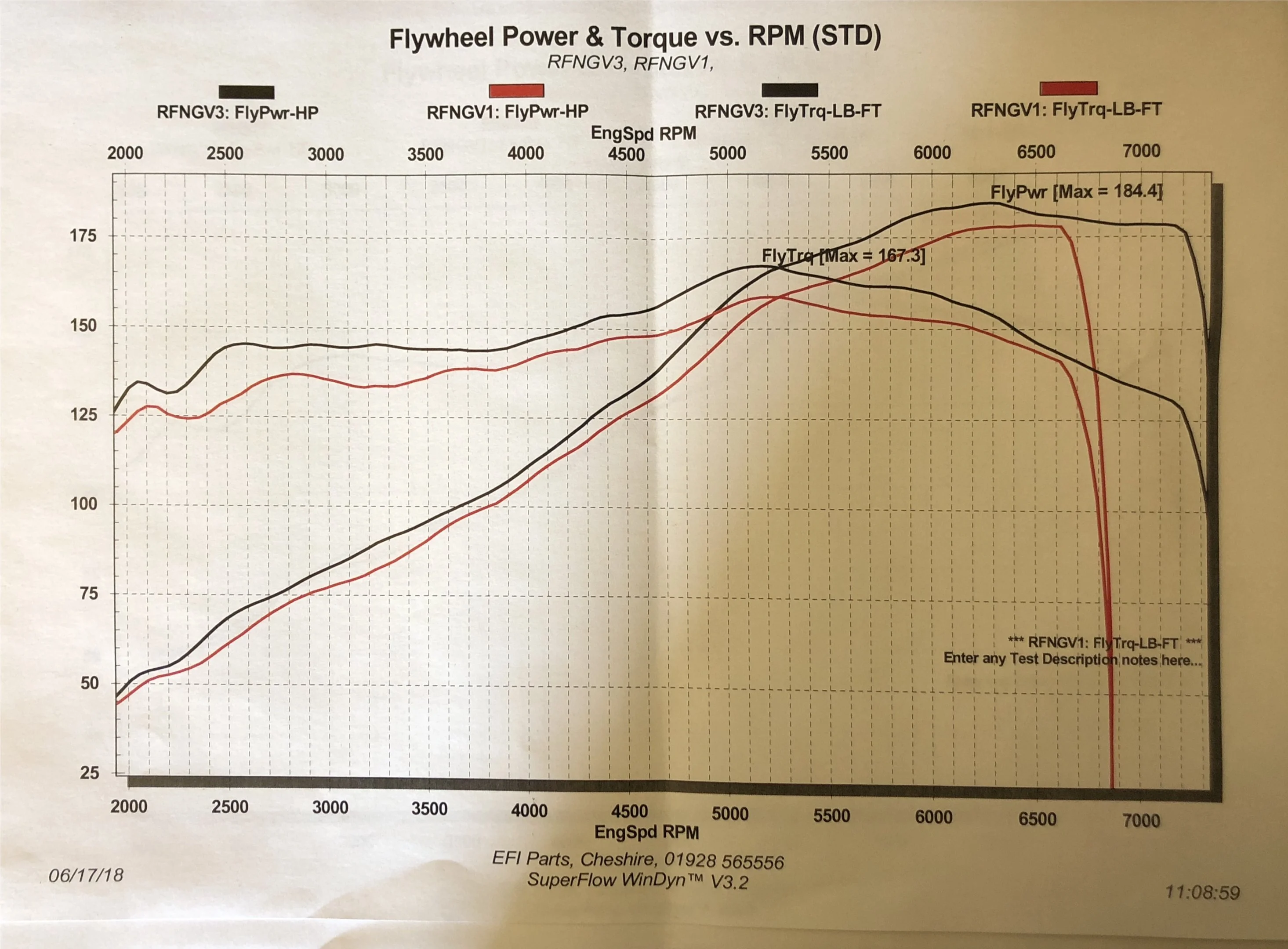

A few months back I had my car mapped at EFI. The engine is close to standard, it's had the centre silencer deleted and the catalyst modified to remove the olive join.
I was unsure about what induction to run so kindly Chris at EFI offered to test both the standard airbox and the fatty set up back to back. He did three runs of both and here are the results: Black is airbox - Red is Fatty
As you can see the standard airbox has a noticeable spike in torque in the mid rev range!
In the end I decided to run the fatty for the remap and here are the results of that: Red is standard with fatty, Black is mapped with fatty.
As you can see the there are some good gains with the map throughout the rev range!
Interestingly, Chris reckons that a remap with the standard airbox would see similar gains throughout the rev range and keep the mid range torque spike you see in the first graph. I'm happy as even with the fatty, I've still got plenty of low end torque. Car drives really well and idles nicely, not a massive peak gain but you really feel that extra 'area under the graph'.
Big thank you to Chris at EFI for doing this for us, I was looking for this info before I got the car mapped. Hopefully this will help other people make a decision on what they want to run!

Mines mapped with a fatty style kit, similar figures too yours.
Sorry yours is 167lb mine was 163.

The standard air box will have been designed to deliver the most power while being effective at filtering air.
I believe that the “acoustic valve” so readily binned by owners is there to increase mid range torque by altering air flow in some way.
The acoustic valve was installed for this rolling road run.

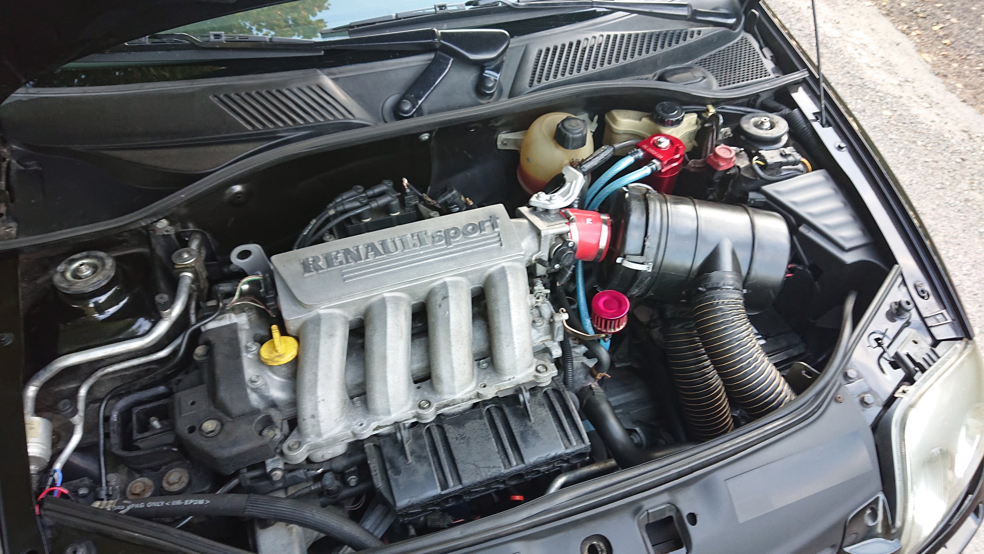

I run a Ph1 airbox
with Itg filter on the side of the throttle body.
Sounds brilliant without the cold air feeds but I keep them on, not sure I notice any difference.

No at the wheels, on a rolling road after it was given a custom remap. (using said rolling road)
Before the remap it was about 150bhp at the wheels according to the printout.
I would expect a standard Clio 182 to put out close to 180bhp at the flywheel.
MorroN
Got a print out? 30hp gain from an exhaust and remap seems... a lot...
