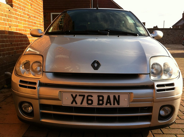

DONE! Here the results.....

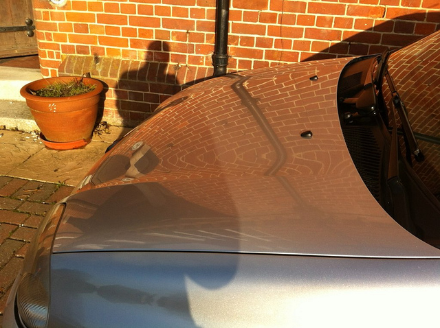

Bloody car park dings!!
Quite impressed with the reflections...and forgot how good Titanium fleck comes up when cleaned!

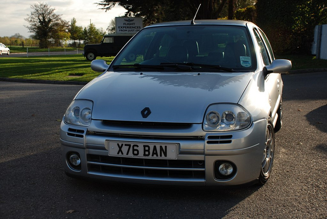

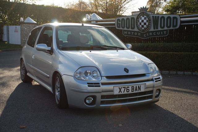

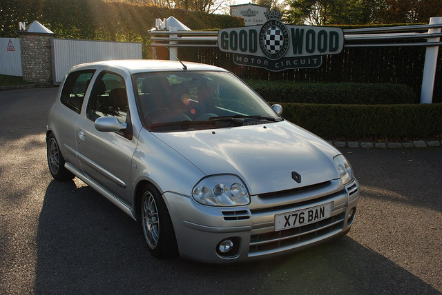

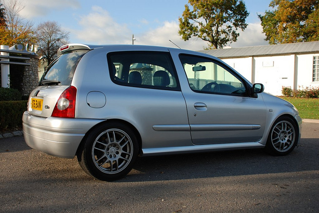

Then I decided a quick spin up to a better photo location was in order.....only 5 hours late!
So...a long day of washing and polishing but I'd been meaning to do it since I picked her up, so I'm glad it's out of the way now and she should be well protected through the winter. Can't wait until it rains now to see the bead-age! :cool:

Too right....going to see if it can be rectified soon!
imprezaworks
  Mk5 Golf GTI :)
Lol was thinking the same ref the dent. Ph2 rear lights are growing on me. Overall it looks spot on
