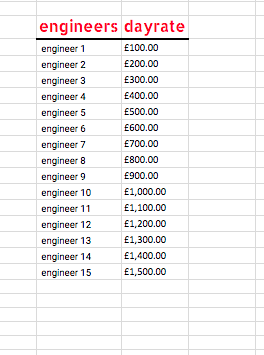

Put the engineers and their corresponding day rate in a second sheet, then the function you're looking for is vlookup
Hope this helps
  Clio Sport 182
Create a table of the engineers and their daily rates. Then do a validation in the engineer cells using the engineers column from the table above (that'll give you a drop down of the engineers names to select from). Then in the daily rate column do a vlookup of the selected engineers name from the table of engineers and rates. Hope that helps - if you're not familiar with validation or vlookup then you may need a hand.

Thanks chaps - I'd already set up another sheet with engineers names on (Which would feed the drop down menu). Then following this () tutorial I've created the below (engineers and day rates are not true believe it or not)

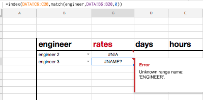

however, when I go to the sheet I want it to output - I get this..
this is the formula I'm using - the range was named to INFO..

I use index/match as it's more versatile than Vlookup.
It's
=index(dayratecolumn,match(engineer,engineercolumn,0))

The issue in your vlookup is you've told it to give you the values from column 3, but your table only contains 2 columns. Change the 3 to a 2.

interesting - how does that break down? I assume dayratecolumn and engineercolumn are just references to the said column in the other sheet? what does engineer then represent?

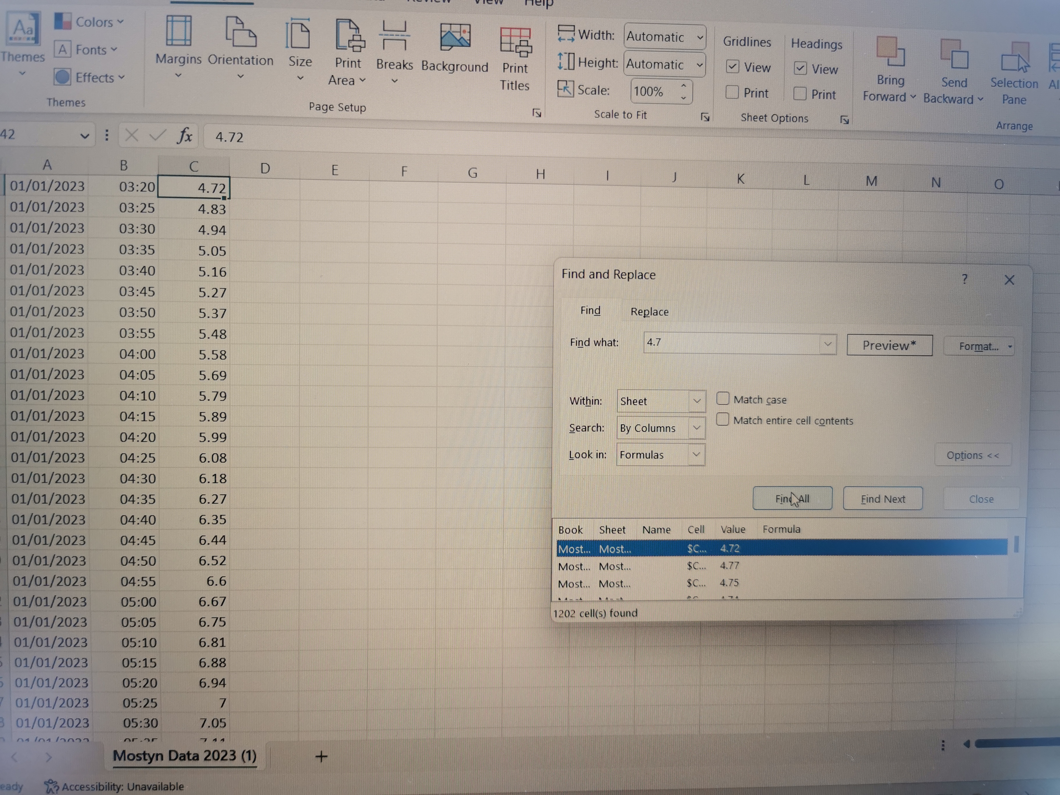

I've got a list which is set at 5 minute intervals for the year of 2023.
I need to select in column C a range between 4.60 & 4.80. Then I need to put it into another sheet so I can select a few times for each day (for access to a tidal port)
If I search for 4.7 I can find them all but the dates don't show (as above, it just shows book, sheet, etc, but no date)
Couldn't see a range to search for though.

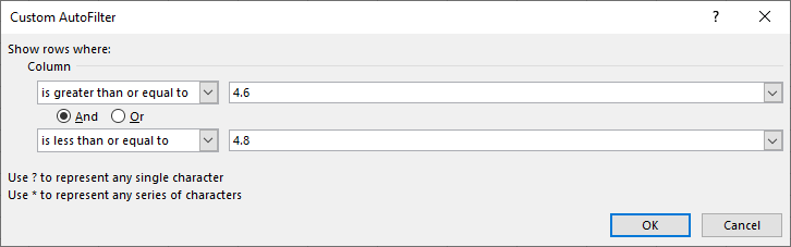

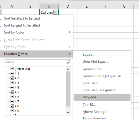

Would just adding a filter to the tab hel. Then select only 4.6 - 4.8 tide height to display.

No need for colours, just filter the number betwen 4.6 - 4.8

Cheers guys.
Done the filter thing and have now copied May's over to another page. Just needed pictures to assist.

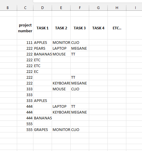

I have one spreadsheet that I need to ideally VLOOKUP some data from another sheet (full of mass project data).
I have used VLOOKUPs all over the place on this, however, this is a bit tricky as the data I'm referring to could be anything from one line to 30+ lines of data so I'm not sure how to go about it...
I've found FILTER may be where I want to get to but not getting where I need to at the minute...
The below is a quick idea of what I need;
This is where all the (fascinating in this case) data is stored
And this is where I will need it to display, dependent upon the project number akin to a vlookup.

Ok, cell E7
=IF(INDEX(Sheet1!D: D,MATCH(Sheet2!$D$3,Sheet1!$C:$C,0))=0,"",INDEX(Sheet1!D: D,MATCH(Sheet2!$D$3,Sheet1!$C:$C,0)))
This can be dragged left to right - this will find match#1
For nth matching we need to use an array formula (and you cant drag it down sadly) - to perform an array formula, you must confirm the formula with CSE (Ctrl+s**t+Enter) - your formula will be enclosed in {}
The red number is the result number
e.g. E8
=IF(INDEX(Sheet1!D: D,SMALL(IF(Sheet2!$D$3=Sheet1!C:C,ROW(Sheet1!C:C)-ROW(Sheet1!$C$1)+1),2))=0,"",INDEX(Sheet1!D: D,SMALL(IF(Sheet2!$D$3=Sheet1!C:C,ROW(Sheet1!C:C)-ROW(Sheet1!$C$1)+1),2)))

I can write code to fill this formula down for you rather than you type it manually each time, but I would need the exact sheetnames and ranges etc (if it's not sensitive data, you can send me the sheet to cliosport@ogilv.ie )
