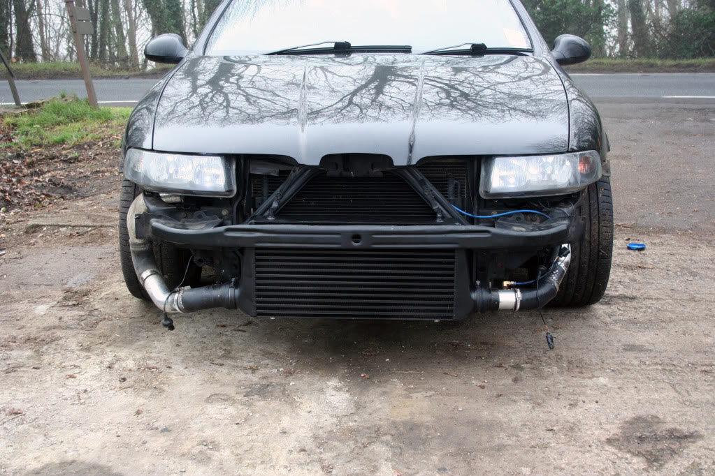

Wanting to spray my intercooler and boost pipes in satin black, will this be ok to do, any advice appreciated.
It's a supercharger set up.
  182
Shall just peel off and look a mess tbh unless there is a specialist paint that can be used? Is it turbo'd or charged??
  Lionel Richie
VHT paint will be fine, its all i use on my exhaust, been on there since may and just needs a quick touch up now
I used etch primer and regular satin black paint on my FMIC.
