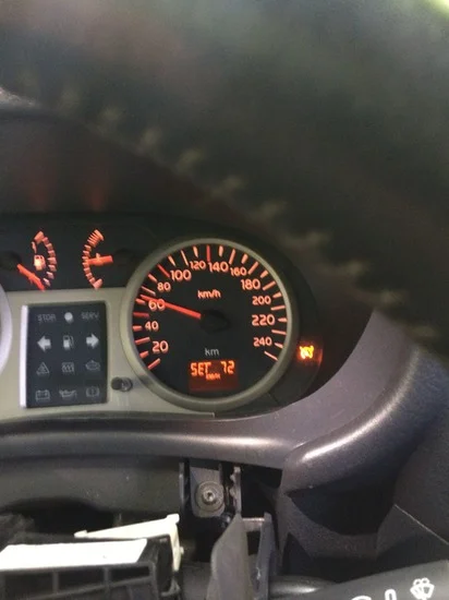

Speedlimiter works, cruise control not

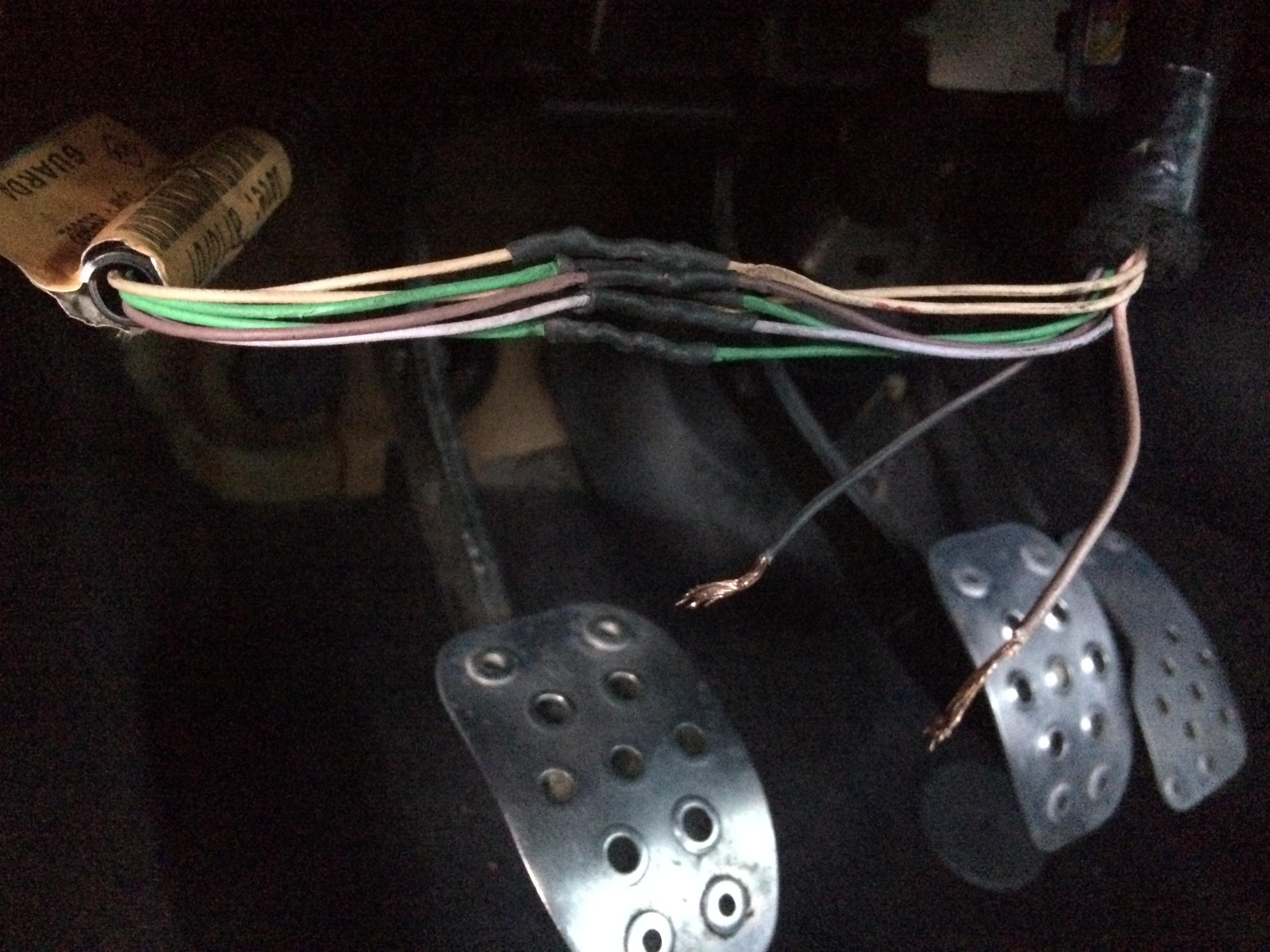

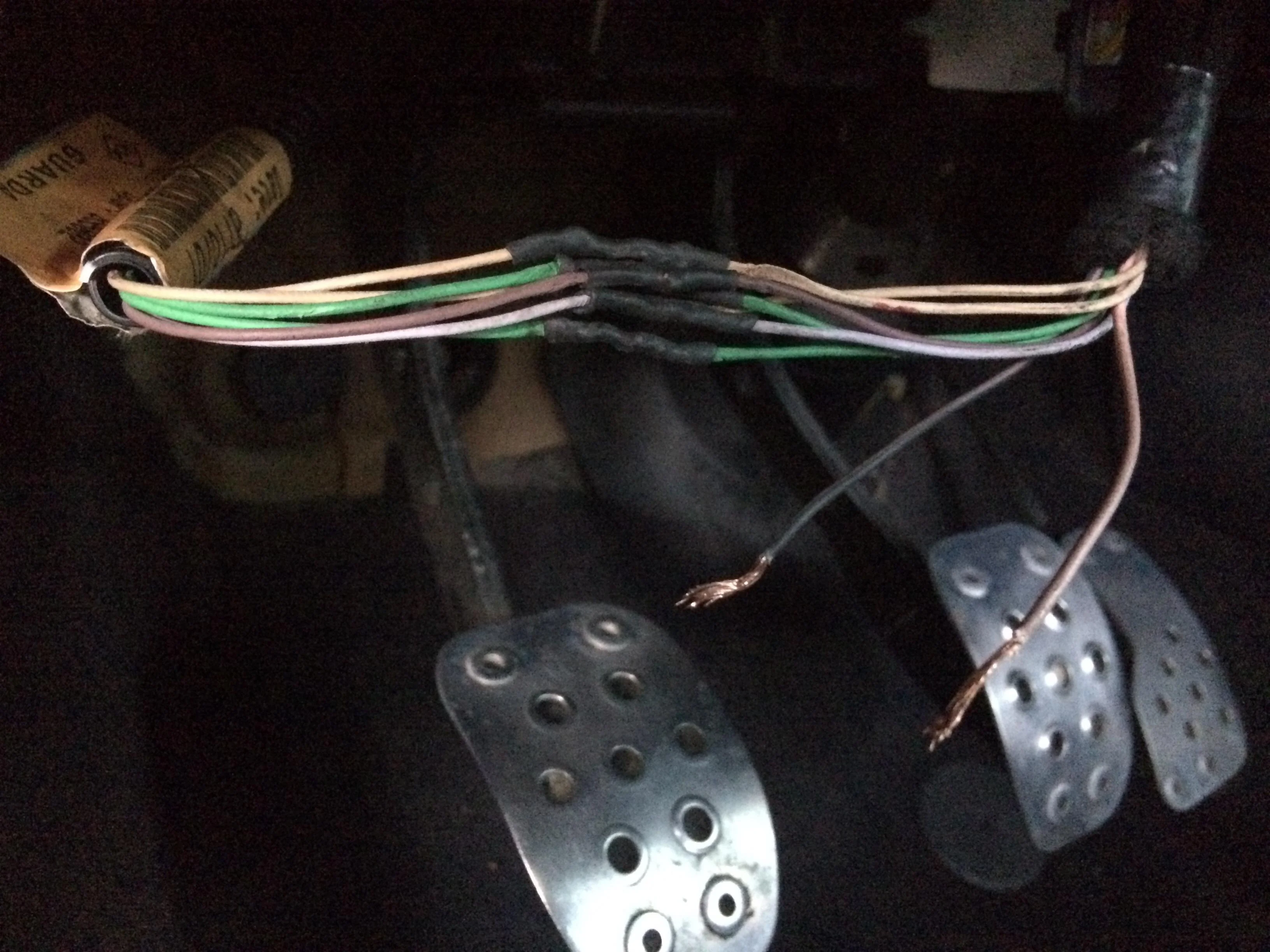

Ive been busy with retrofitting cruisecontrol to my 172 from 2002.
I cant find the loom for the clutch switch. Seems the car dont have it.

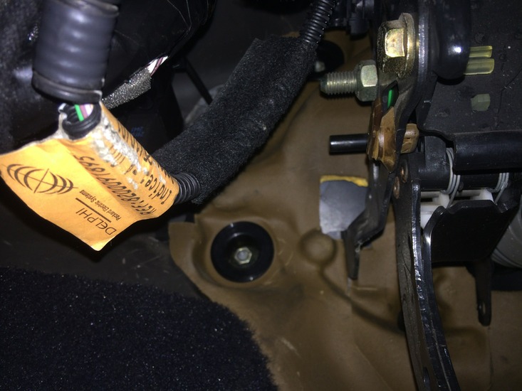

This is where the loom should be i guess

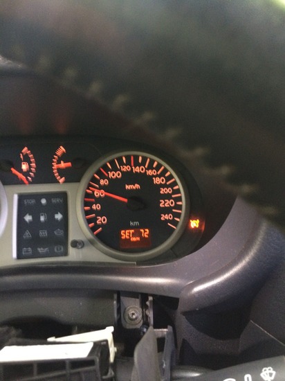

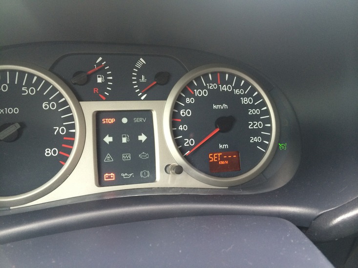

And i know that i need to drive faster than 30km/h or 18 mph. But still i have no idea what to do.

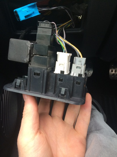

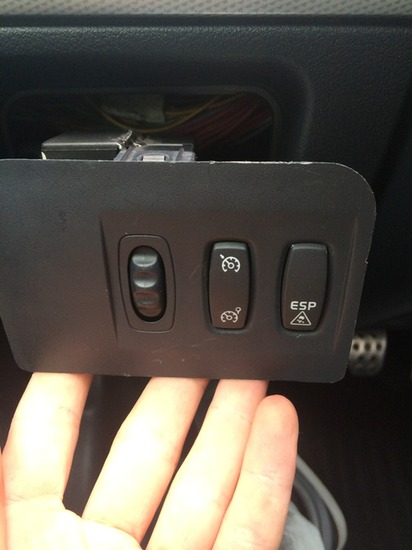

You've obviously got the system working to get your speed limiter to work.
have a look at my guide for cruise control and connect the 12v coming out of the switch to the wire back for cruise. If that doesn't work and it does for speed limiter then the wire to the ECU must be broken somewhere

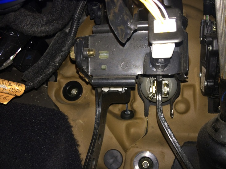

Clutch switch loom has a big purple plug on the end, it will tooked up under the dash somewhere above the pedals
  Clio 2 phase 2 RS172
Thanks guys, but the loom isn't there!

sorry I didn't see you weren't a member. Put a wire between a2 and a3 (cruise on) and then a2 and b1 (speed limiter on)

It's the plug that goes into the cruise control switch. The wire numbers are on the pins of the switch

Looks like the switch bracket on the clutch is missing? Will check mine when it stops raining!

Yeah, but i can't bridge the 2 pins because there is no loom. So i need to bridge it on the ECU i guess?
It is missing from the photo. To bridge the clutch switch you will need to ground the wire coming out of the ecu for the cruise control. However I don't think this is the problem as your speed limited works. Have you tried my test yet?

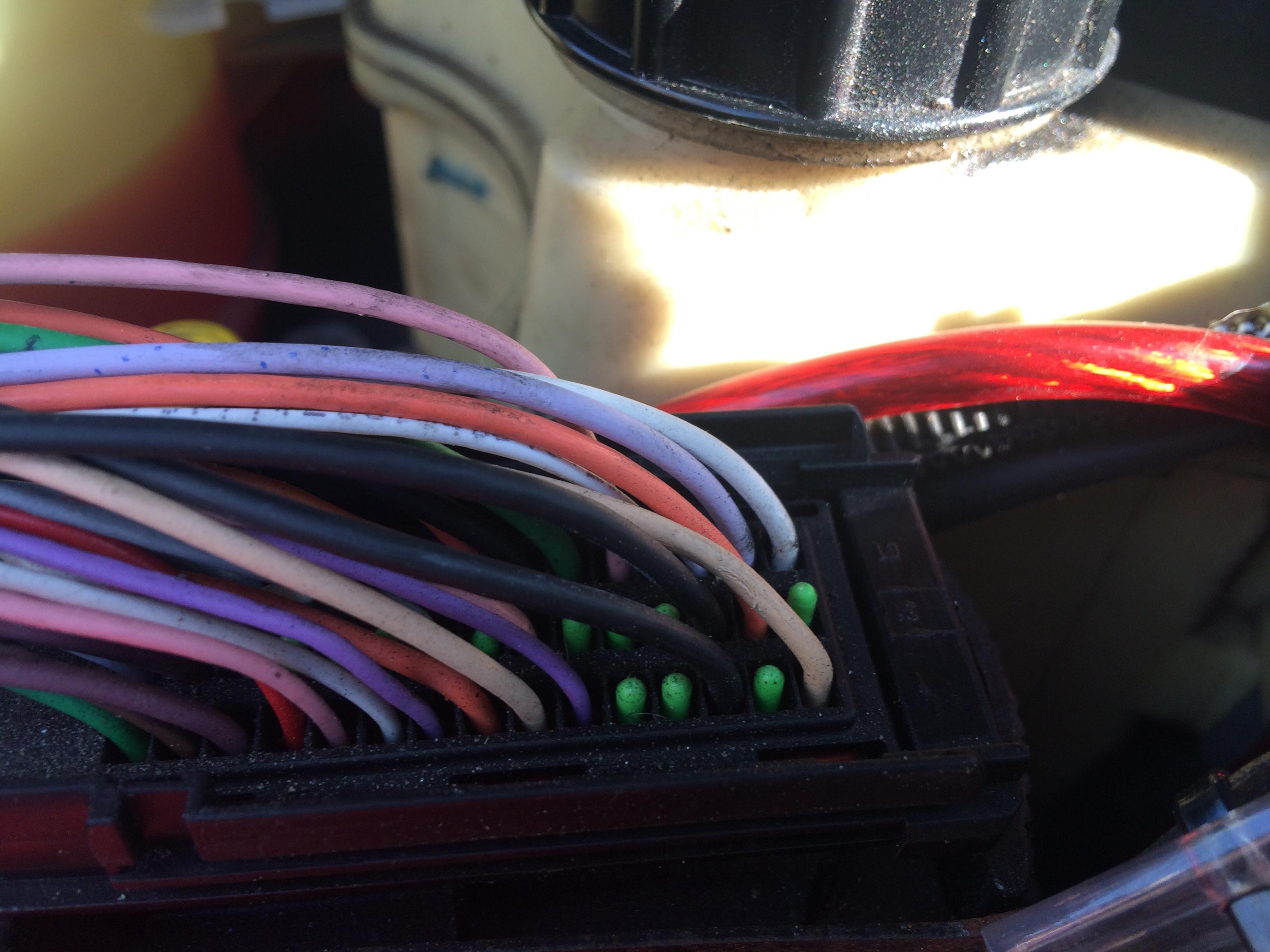

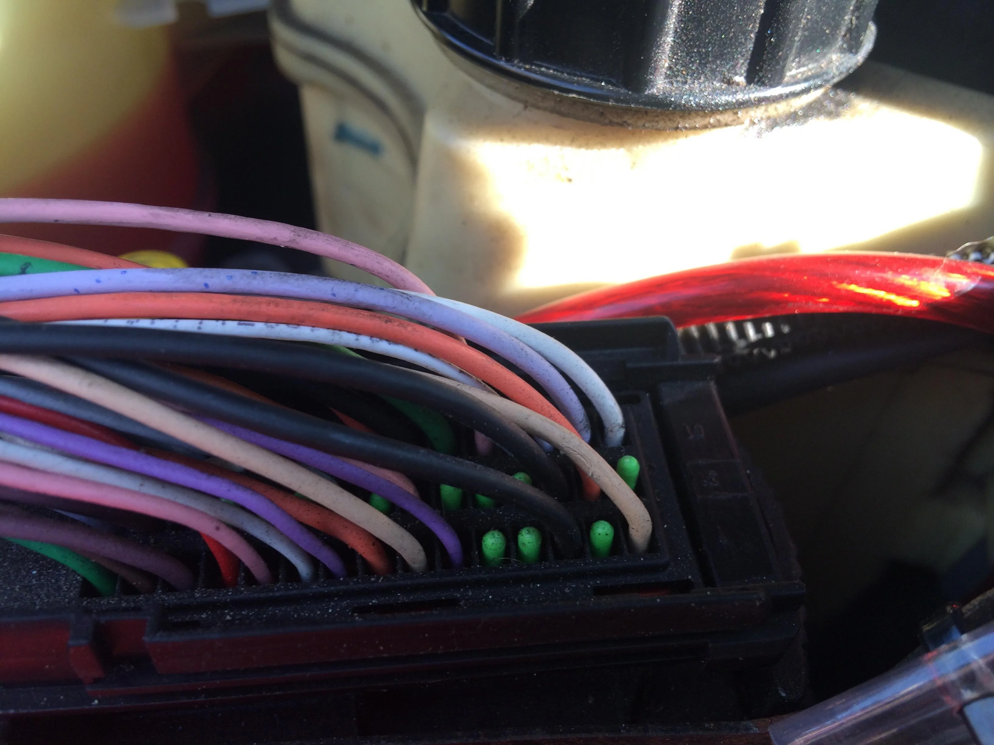

Opened the ECU, as in the guide. But now i have no idea what to do. Thought it was easy haha. Graham, can you help me?

FOUND IT! Seems like the wires where cut. So i searched for the loom, was niceley worked away.
So i connected the 2 loose wires and it worked. Thanks for the help folks!
