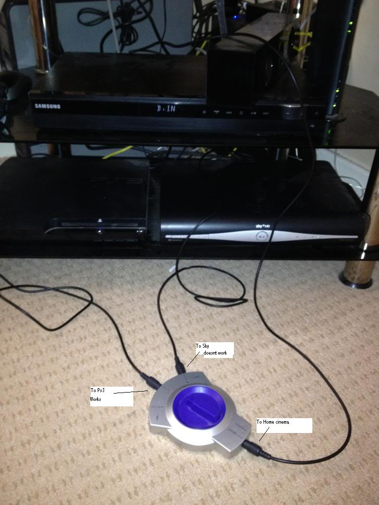

heres a picture of the optical setup
as i said PS3 works no matter what socket you put the cable in, sky works in neither. the only way to get sky working is by going direct from the box to the home cinema
