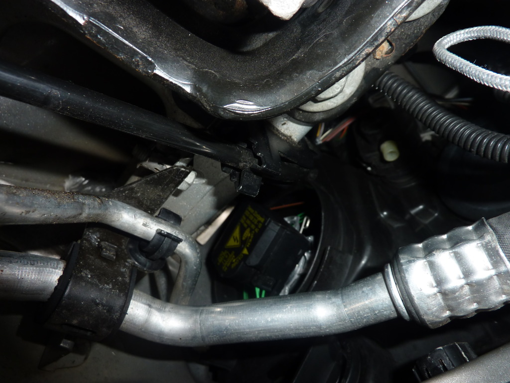

What does the ballast look like? Is it this black box thing? Or is it something else?
The ballast is screwed under the light, undo the 3 bolts holding the light to the car, un clip the two plugs, take both lights out then switch the ballasts over, if that doesnt work switch the igniters (black box yellow writing).
  182
The ballast is screwed under the light, undo the 3 bolts holding to the car, un clip the two plugs, take both lights out then switch the ballasts over, if that doesnt work switch the igniters (black box yellow writing).
