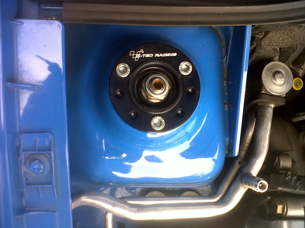

got the ktec ones, cant fault them. but if i knew "Pure motorsport" had thier own version inc strut brace (group buy on here somewhere) id have them

i had k-tec's early design ones and they were terrible from my experience. they were the compbrake ones branded by k-tec i believe. but they were terrible. they rattled even on smooth roads and a very loud rattle at that.

mine, like i said i cant fault them

Is that a picture of yours Emma?

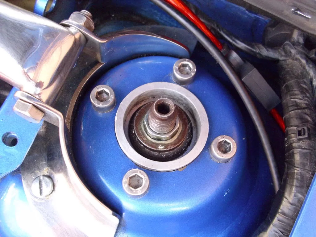

Apologies for hi jacking the thread. Im running fk coilovers, front strut brace and new but standard top mounts. will solid top mounts from either pure motorsport or ktec ones make a big difference?

Yep - by far the best kit
Top mounts bolt directly to the strut brace. Exact copy of what the cup race cars run
If you want to adjust the camber/castor with the top mounts then I'd probably still get AST - but if you just want solid top mounts then the Pure Motorsport kit wins hand's down

The Pure Motorsport ones come with a strut brace - and they bolt through into the strut brace. Very rigid
The others I assume will fit with the strut brace on - you'll need to check for clearance though
