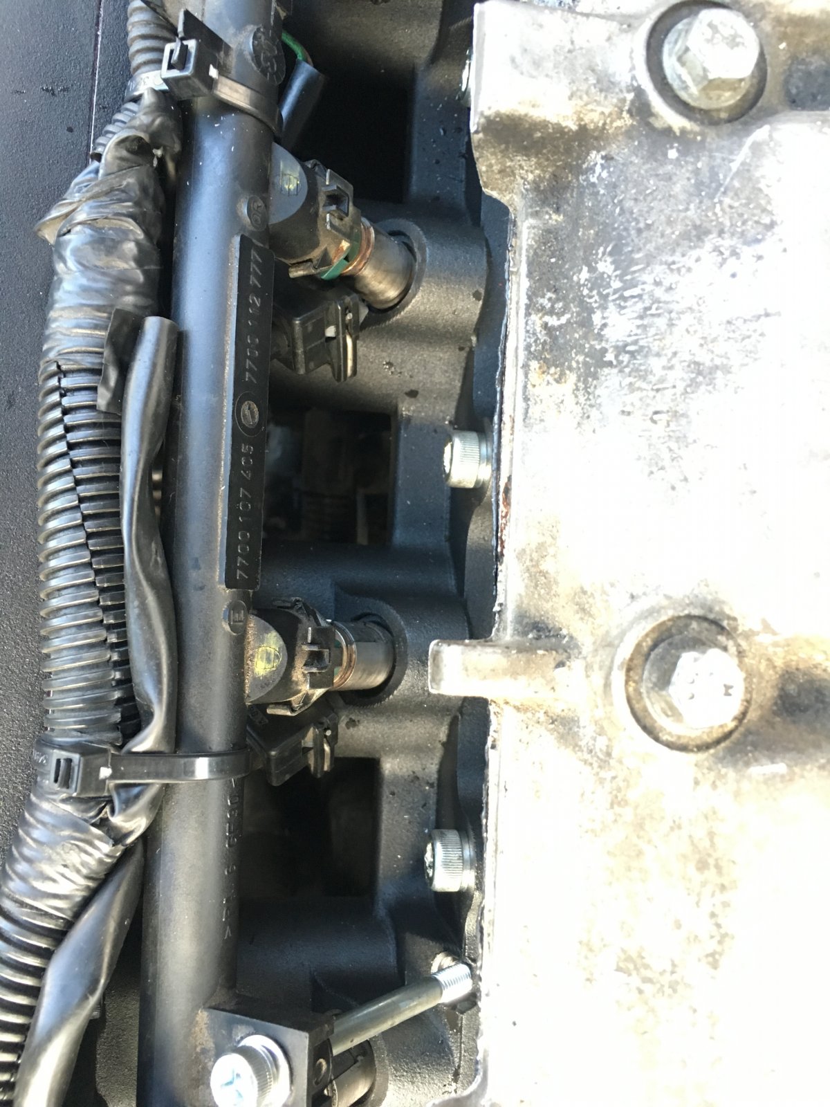

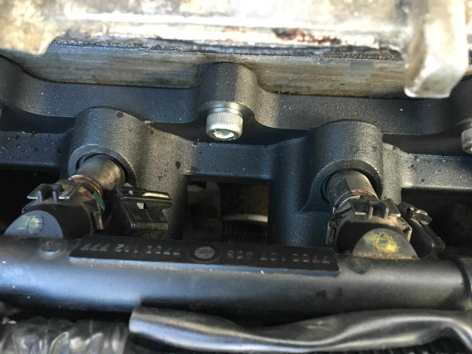

The problem i'm having is the plugs for the injector are hitting the intake and off setting the injectors slightly.
I've heard there's a fix but I have no idea whatvit is, any one know?
Cheers,
Tim

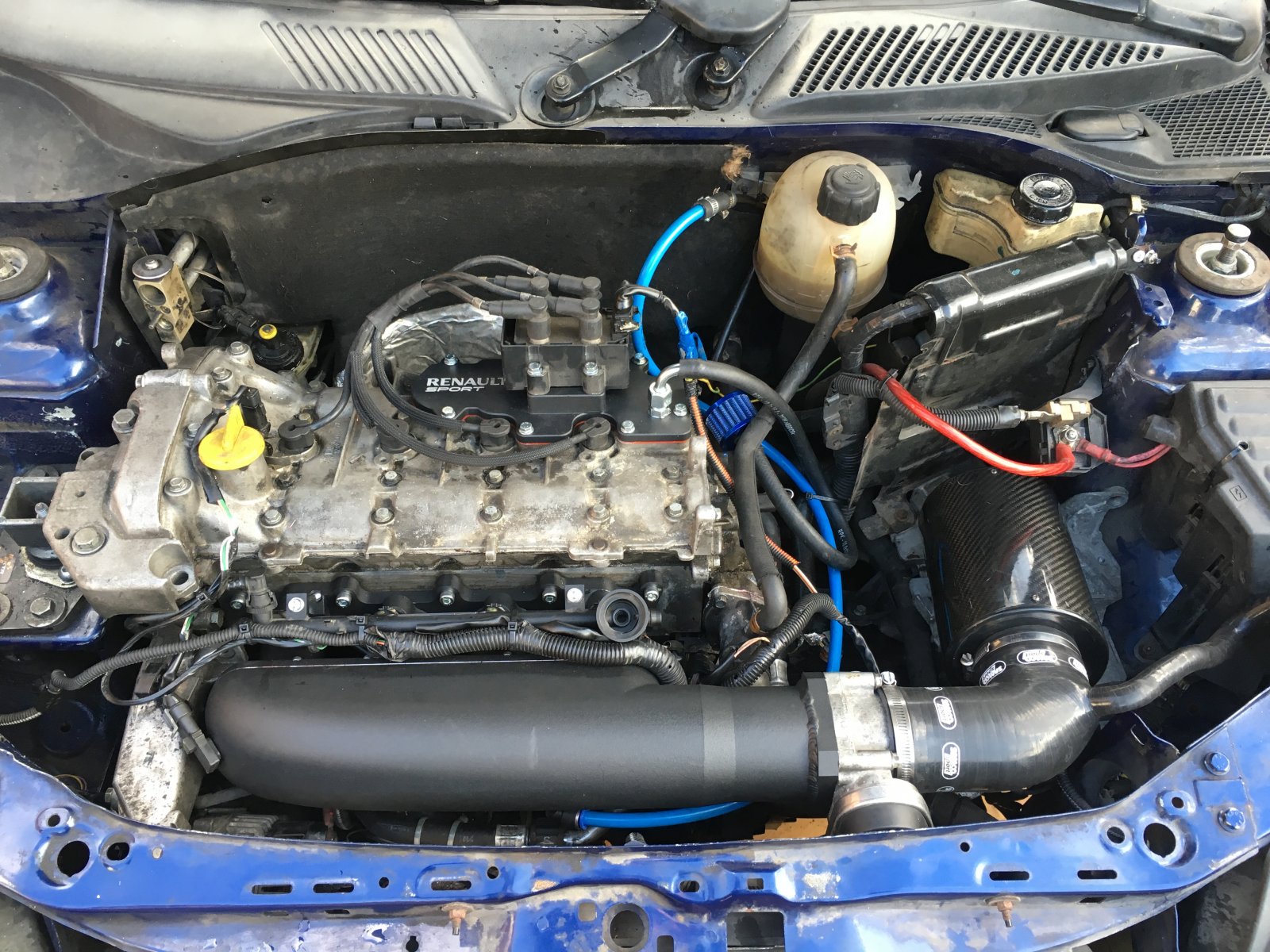

Looks really good. Cant help with the injectors but would recommend the injector loom goes under the inlet if that is possible for neatness.
Edit - also the 90degree samco bend - is the small pipe that comes off it blocked.
Trackslag172
  03 Clio 172
Cheers,
Yeah I did have it under origionally, but i'm always fiddling with it so i pit it above for access! The car is not a looker anyway!
Yeah it is blocked, i'm going to get rid of the 90 and have it straight on the end but i need to cut out some bodywork first

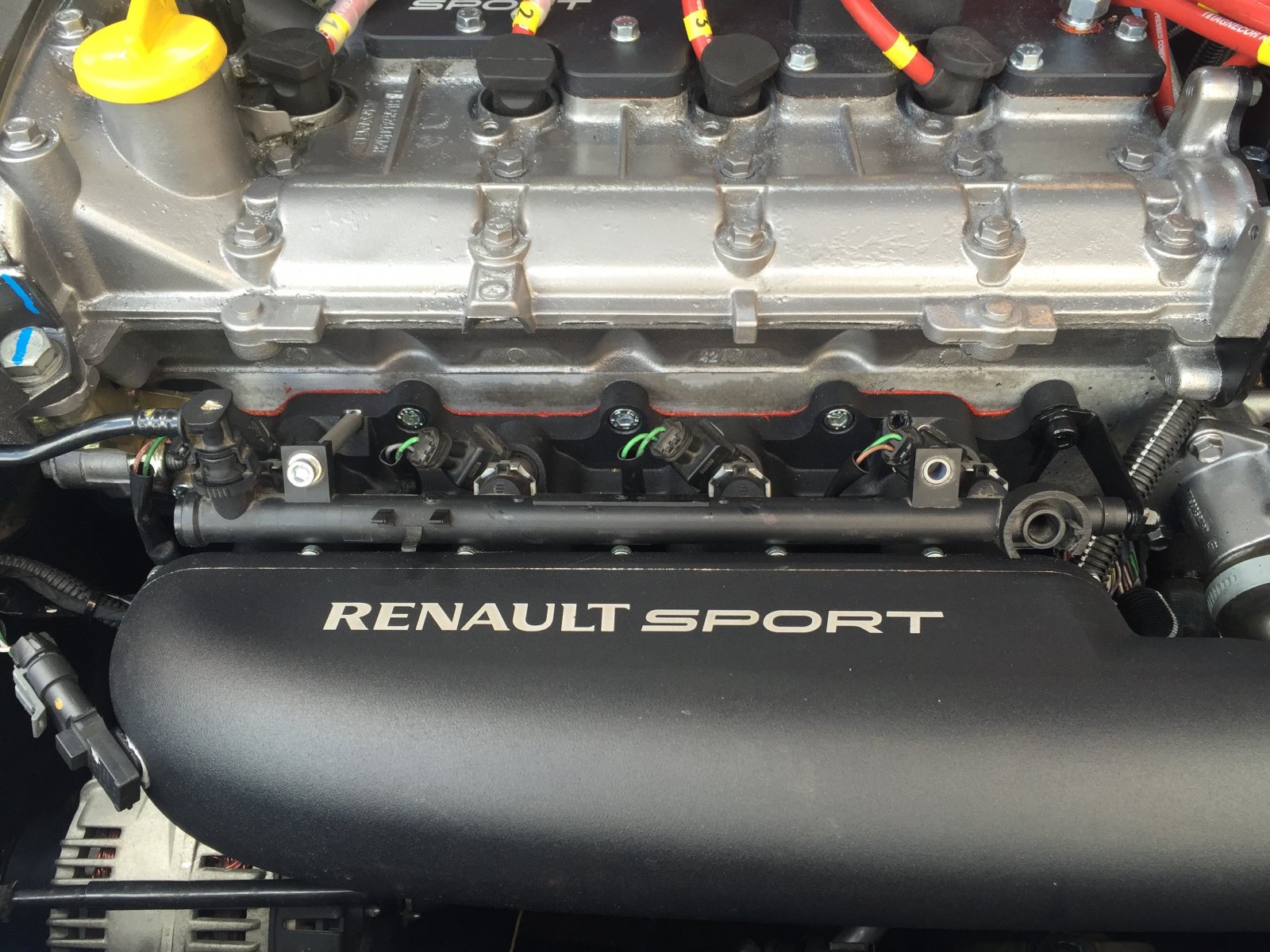

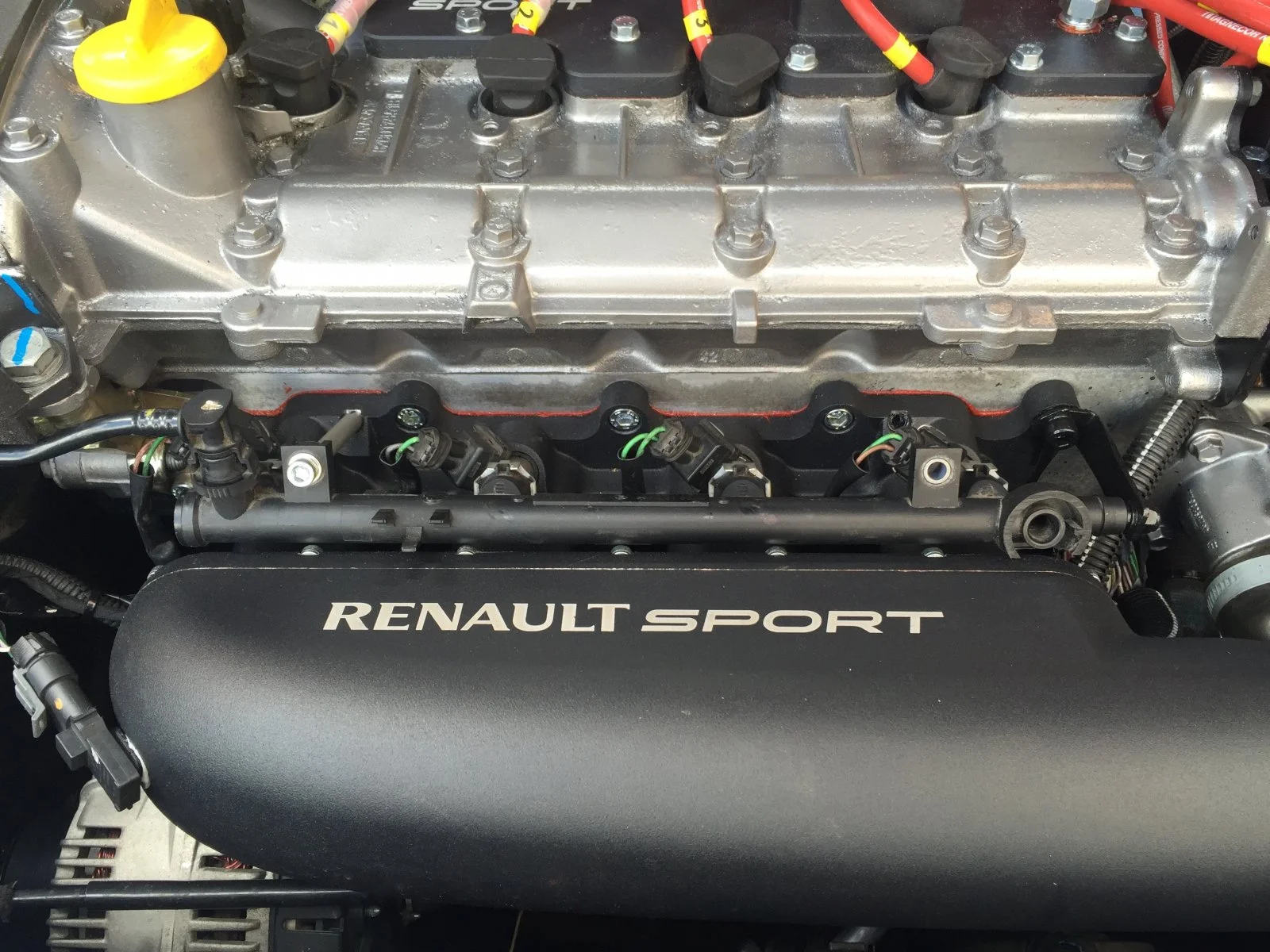

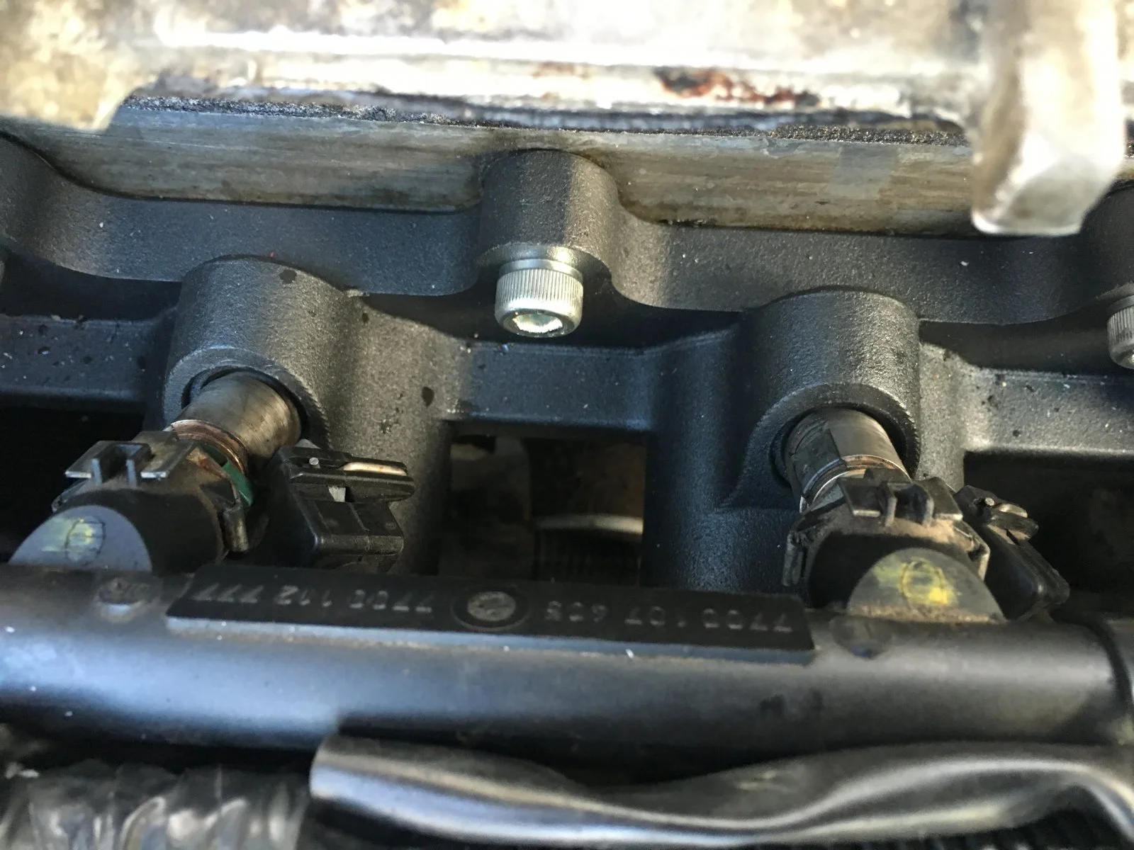

Tim, hope you're well! I've just fitted mine as well. Had it rolling roaded at Engine Dynamics yesterday and Andy said because the injectors have a 4 spray pattern, you can run them at 180 degrees to how they normally sit. Therefore, I'm pretty sure mine were nearly pointing upwards when I took it into him, however he might have moved them subsequently, I can look when I get home if you want and confirm? Otherwise I'm about in the morning and you can pop over and take a gander. Alex
bashracing
180 degrees,
also spot the little bracket on the right hand side of the rail as the mounting bolts interferes with injector plug on that end of the rail
Trackslag172
  03 Clio 172
That's perfect mate, thanks. I'll flip them around tomorrow.
