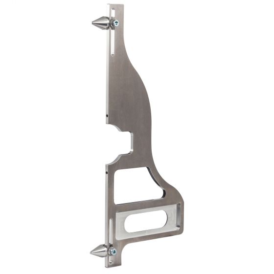

This is where one of these with alignment done the manual way works best.
Digital gauge mounted to this...
