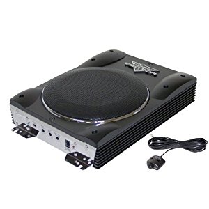

Anyway I want bass but dont want a dog kennel in the boot. Been doing some searching and there are some Slimline Subs for around £60, anyone got one? When I say I want bass I dont want the car to vibrate like ann summers best seller, I just want a subtle kinda bass and these seem ideal and perfect size to hide under seat or in the corner of the boot (the Audi one was in the parcel shelf).

This is what iv been looking at Lanzer. Will do a lot more searching and read reviews elsewhere as well.
This could also go in the corner of the boot and still have 90% of the boot.

I guess it has something to do with the name haha and same 13cm speakers is all iv found out. Im thinking of replacing these and buying something on the lines of this sub should be around £150 all together along with a decent headunit I already have should sound good hopefully. Just need to read reviews see how good they are.

the build quality would be what you are paying for as lanzar isn't the best tbh
and i'm highly dubious of there power ratings
imho for £50 these are decent
