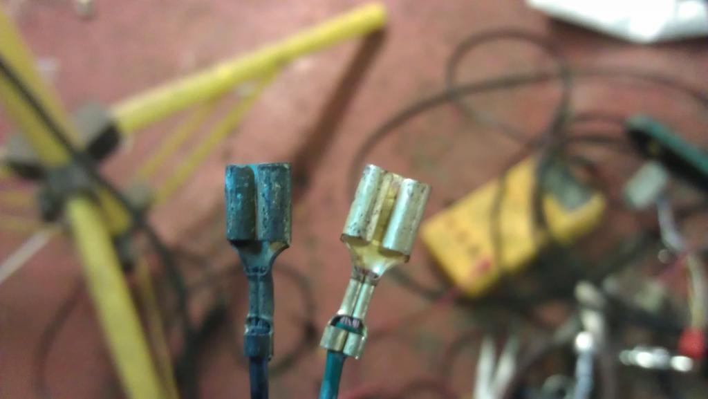

Silly question but what is best around the house to clean the connectors with please? I read wd40 but not sure.
  dan's cast offs.
contact cleaner, gt85 etc. if they aren't that bad.
for bad ones i use acid wheel cleaner, quick spray, leave for few seconds, neutralise and quick spray with gt85
