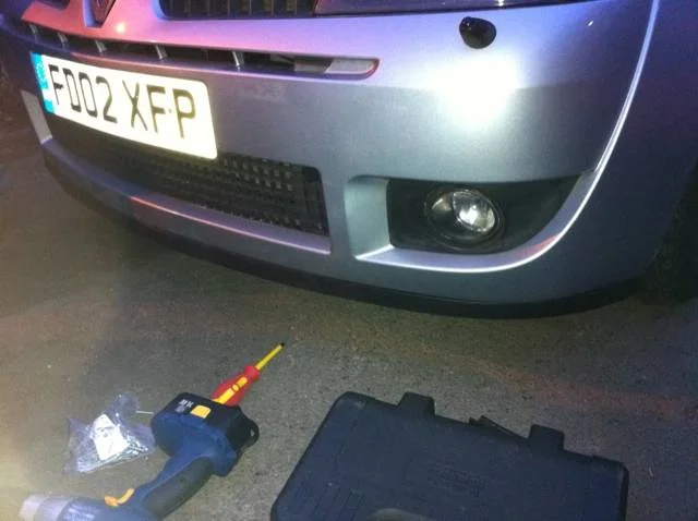

Fitted mine tonight easy as pie thanks again for the heads up looks a lot better than the 1.4 one that the previous owner had bodged on that didnt even reach the edges of the bumper!
