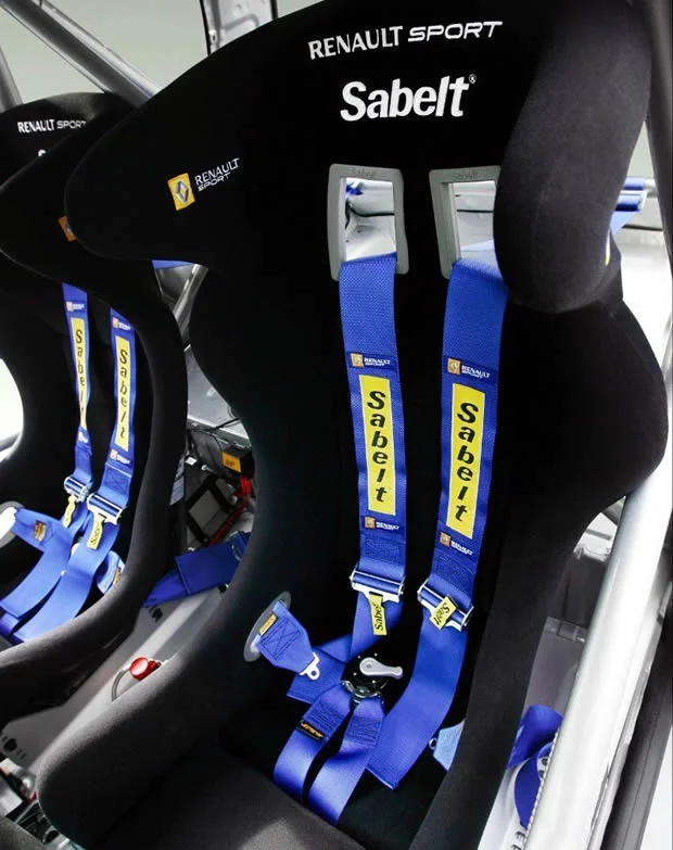

Can you see the bottom of this picture the mount doesn't go under the seat but comes out to the side? I just am unsure the car shell has enough width to allow for this.

Surely it doesn't have to fit that way round? The seat i've got is only a Medium anyway, and i have no seat rails currently so they are going to be welded Bespoke to suit so we can sort something out i'm sure :)
That picture makes me very excited for my new seat, do you find it comfortable?
If you turn the seat mounts the other way round then they will foul the seat. I would just go with a side mount like http://www.ebay.co.uk/itm/Alloy-Sea...arParts_SM&hash=item35b801b23e#ht_2539wt_1304 Can you see how the fold goes the other way so that the mounting is under the seat instead of at the side which is what I am unsure will fit.
Yes mate it's awesome, visability is bloody awful though but it's swings and roundabouts and not the end of the world for a track car like yours :)
