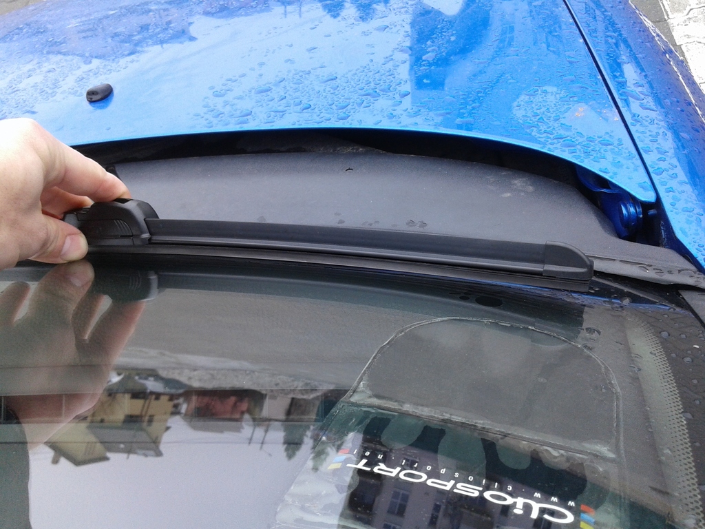

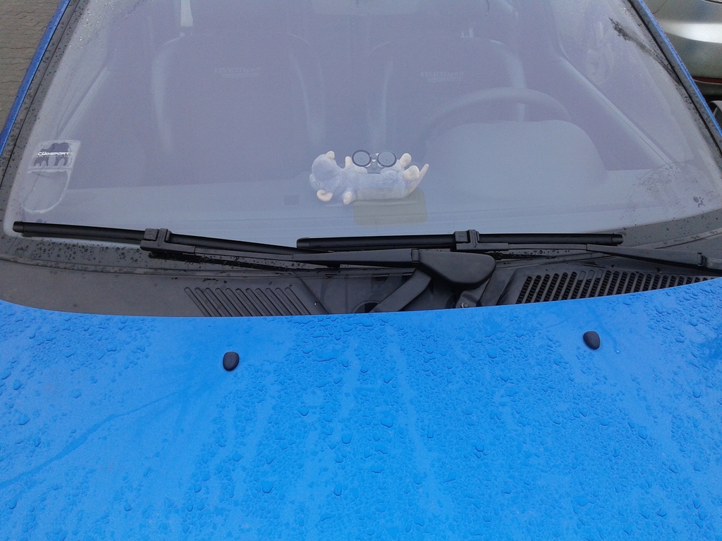

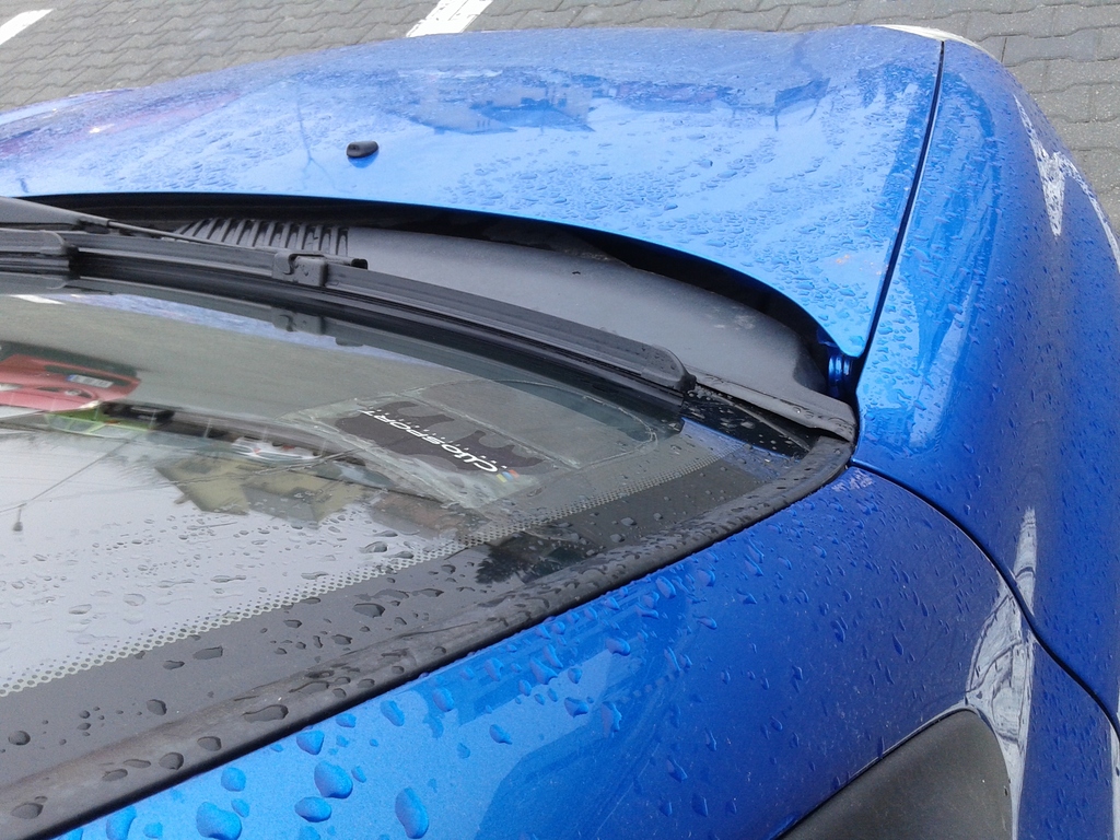

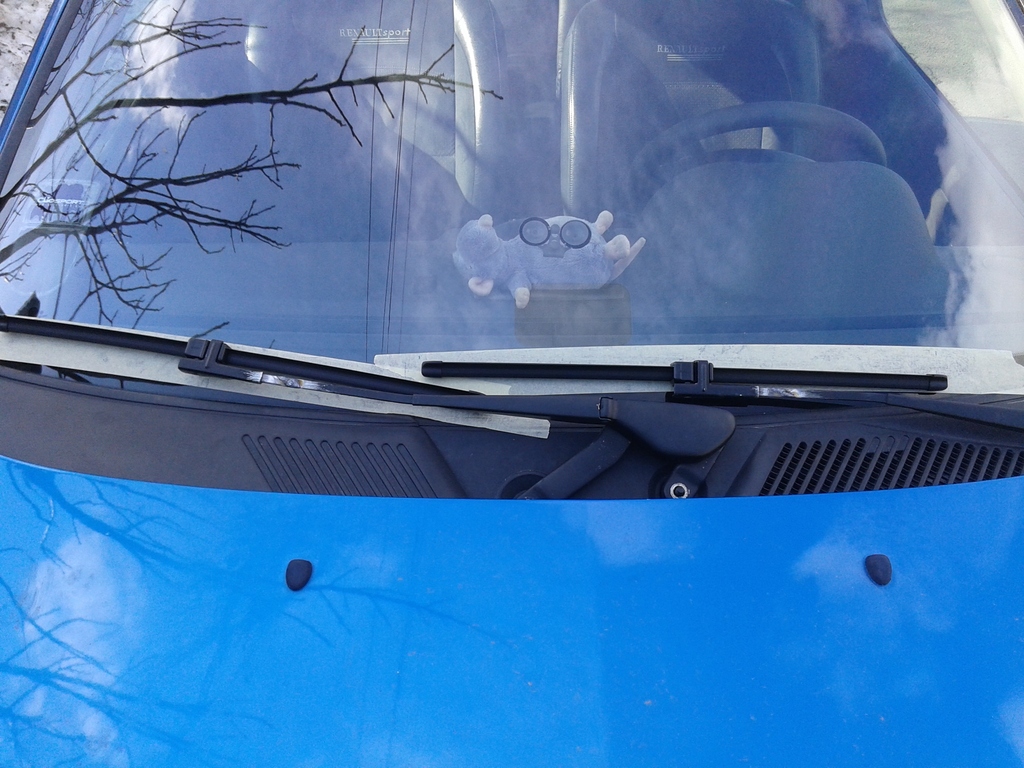

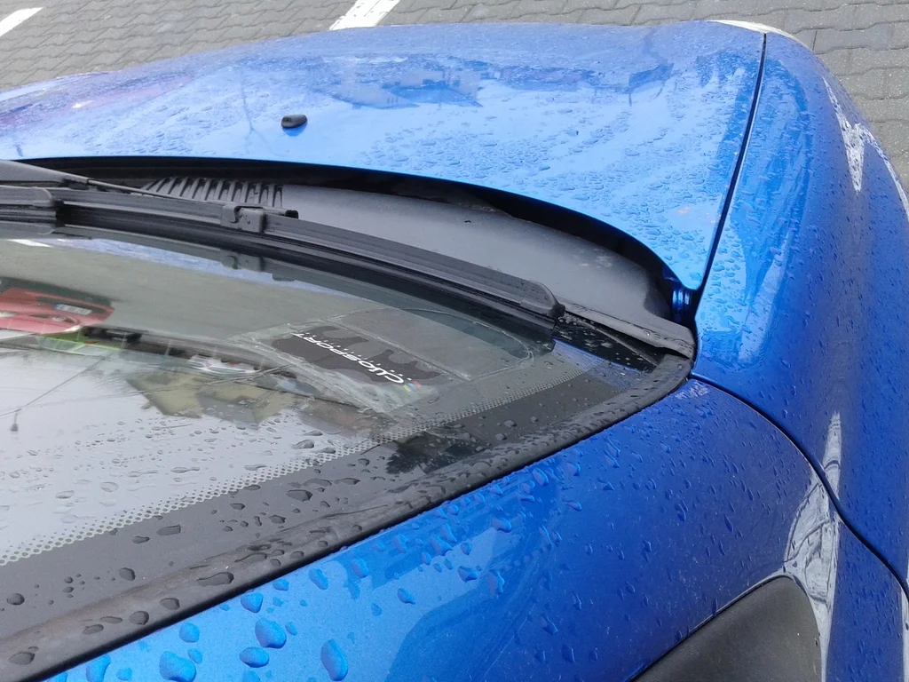

Then I tried some Bosch AR530S retrofit aero wipers which were nice, well at least the one in front of me because the other one didn't fit the screen so well:
You can see the end being lifted off. It also didn't quite swipe the rain sensor area so put them back in the box.

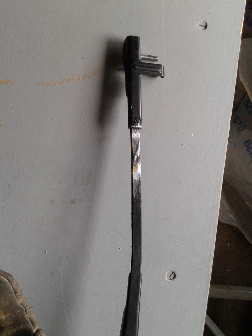

So went and bought two focus mk II arms, cut the ends at an angle and welded them to mine. First I marked the original position of the blades:
the welding:
first fit to the car:
Then polished the weld and painted the lot, ended looking like this:

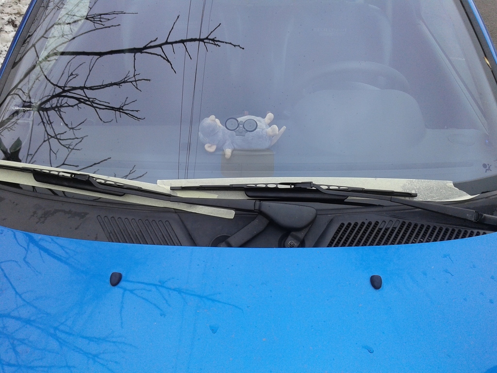

Really pleased with the result, they work perfectly and the best thing is that the right side wiper covers the screen almost perfect.
Here is the VW specific blade covering the screen (much better than the first pic showing the retrofit blade):
