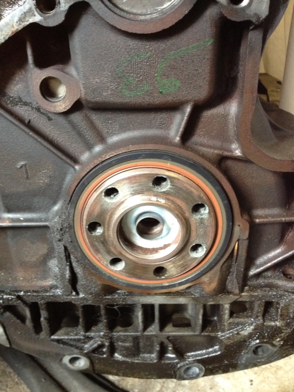

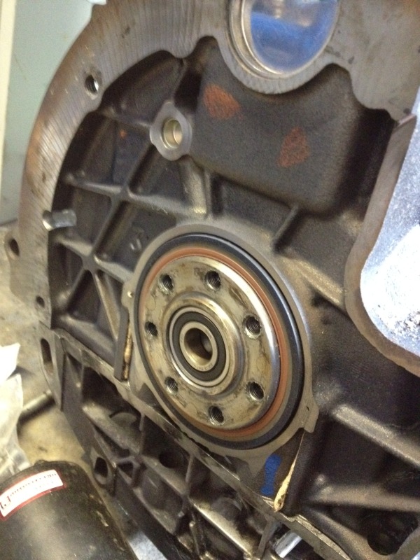

Ok so following my project thread which got mixed replies, some saying yes, some saying no i really don't know if my 182 engine is meant to have a bearing on the end of the crank.
So i bought the 182 with a slipping clutch, and thought nothing of it as i was planning on swapping the engine for a 225 engine anyway. But due to a change in my circumstances i'm now putting the standard engine back in, but i noticed when i had the 2 side by side swapping the flywheel and clutch back to the 182 engine, that the 225 engine has a bearing in the end of the crank, and the 182 engine has what looks like a casing in it. Does anyone know for sure?
225 engine.
182 engine.
Is this right? If not i guess i'll need a bearing, could this also be why the old clutch was slipping and show's signs of extreme heat? Could my flywheel be buckled from this?

Looks far too clean in there. My guess is the bearing should be there!
The clean one with the bearing is the 225 engine, it's a brand new engine. It's the old 182 that doesn't have one I'm concerned weather it should have one? As it was having clutch problems before i took it out.

no, 182 engine doesn't have a spigot bearing. The pressed piece that's in there is part of a clutch kit for alignment

Went to Renault and it shows that bearing as only fitting Megane engine!

Whats the bearing for though on the meganne? To support the loading on the gearbox input shaft?
yes, Most renault engines are peculiar in the fact they don't use one. Majority of all engines use some kind of bearing or bush
