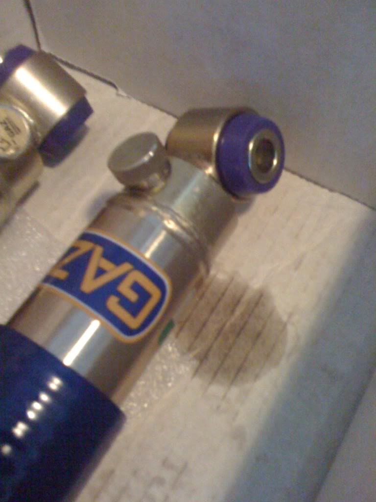

Should I be concered? Opened the box and found....
  Clio 172 Track(ish)
this:
Looks like some fluid has leaked from the damper and onto the box? Maybe im being naive but is this right? Both dampers in the box feel kind of greasy.
Cheers all.

Back in the day (2004) when i had some, the rear shock lasted about 5 miles untill it spat its fluid. Horrid things, sorry fella :(
Might be something and nothing. As they are new and metal, they probably will be oily to the touch anyway
  Oil Burner
Leave the shock on some paper to see if its still leaking? Might just be grease left on the shock somewhere.

Ok, so it would appear they don't have a good reputation with you guys. what should i do? Send them back? Try them then if no good claim on warranty? Btw what setup should i have bought for £500 that's height and damper adjustable?

One of Gaz Gold rears and one of the fronts both spat out all of their oil after a years use! They where bought second hand though.

I'd send them back for a refund if possible. Why is adjustable damping a priority? A fixed damping setup is better than a poor adjustable setup imo.

It'll just be the oil on them to protect them. Wouldn't worry. Although, GAZ are pasch!

Ok, spoke to Anthony at K-Tec, absolute gent! Explained the situation and that I'd lost faith in the dampers and didnt want a replacement damper from GAZ. Asked if I could swap to one of the basic KTR Coilover non adjust kits and that I was desperate for these as have a trackday Sunday at Pembrey.
So.. he's arranged to have the GAZ/KTR kit to be picked up in an hour, when they've had confirmation that courier has it, they will send out the replacement kit and credit my account.

At the risk of being the only person with a positive comment, ive had my GAZ Adjustables for 4 months now, my box looked like that 2bh. Mine were very greasy to the touch, and looks like they have been given a click blast with spray loob to keep the rust off.
However there absolutely fine, i fitted them myself and ive had it on the hardest setting on the front for all of the 4 months of ownership. (The ride is V hard, but i like it like a go kart, i dont mind feeling every bump hehe)
Handling is very good, much much improved over my stock 172 setup and i drive like a b*astard 24/7. I have the rears 16 clicks down from the hardest setting and thats BLOODY hard, do not even try and put the rears on the harder settings they are very very very hard, to the point where the springs cannot return fully. If you search, ull see my thread about it.
My main criticism is that there isnt very good adjustment on the front, theres supposed to be 16 clicks....but thats BS, there is a hell of alot of adjustment.....i could only just feel the clicks and theres tons more than 16.
I bought mine from Ktec aswell, cannot fault that company.
I have seen at least 4 sets slowly filling the top mounts with their contents. They 'adjustment' knobs on the top of the shock literally look like they have been carved with a file - so so horribly finished.

Agreed visually that is true, the adjustment bit looks utter tosh. Its a real shame they didnt do that bit properly as the rest of the shock, looks well finished.
I shall be checking mine shortly, but the handling is spot on for me, so i guess there ok.

Give it a few more months, you'll be sick of them. My front dampers have slowly leaked their oil into the top mounts, and you can feel the front end happily bouncing away round corners, very little damping force.

^^^ ive had mine on for 2 years, and for the record the adjustment on top of the damper is rebound not damping so if you have turned it to its fullest thinking your making the suspension harder you will get the bouncing round corners thingy going on as rebound controls how quickly the damper returns to a resting state. Damping force can be strengthened by asking gaz to do so.. i did.. they did it at no cost to me :) yes there is better suspension out there but ive never regretted buying mine although they cost me £379 new rather than £500 or so which seems a bit steep tbh.
