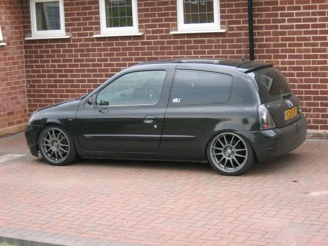

Looking at pics of your car it's pretty low - but being a non sport bumper it looks high from the front

Surely if you have already had your chassis notched to go low then you will struggle to go any lower?
That looks pretty damn low to me though! What coilovers you got? Maybe worth just changing the fronts to a different one? My old vmaxx ones would have gone right down till the bumper touched the floor tbh.

Well.. no theres a fair bit of room left, trust me ;) and i need to fill that damn arch gap..

120mm on 17's.. nah.. thats got to be impossible.. mines like 110mm on 15's and its like 5mm off the arch! on the rear anyway -.-

Cant see mine either, yeah that is proper low to the wheel, yet still practical, where as mine rips catseyes out -.-
