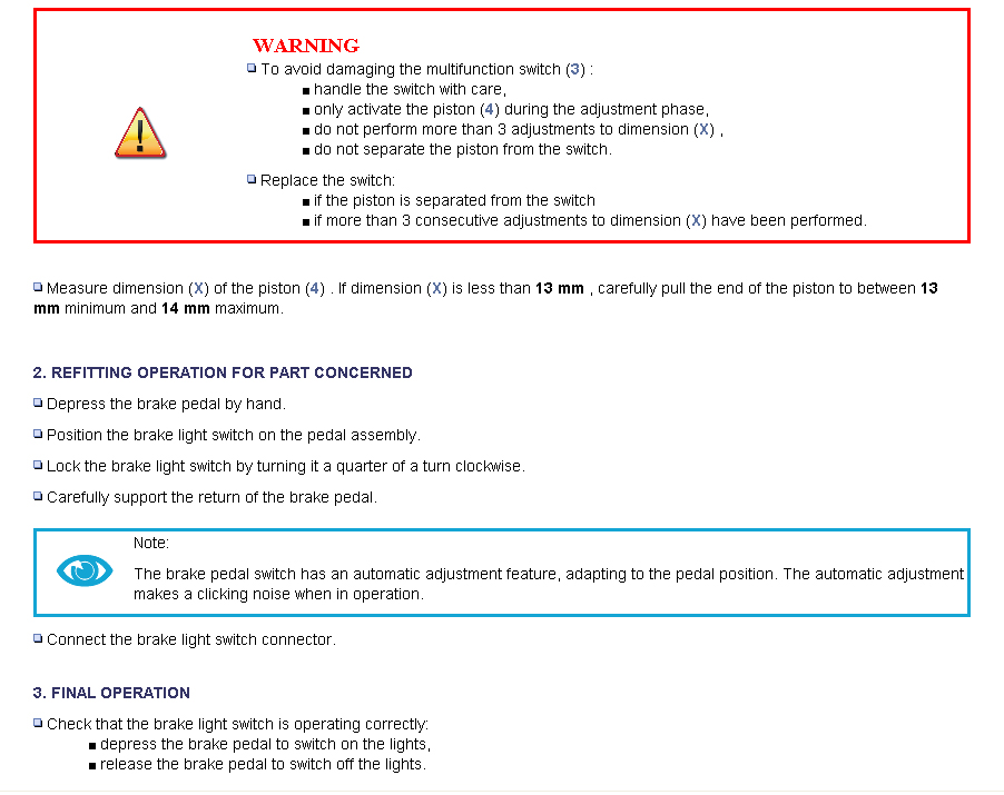

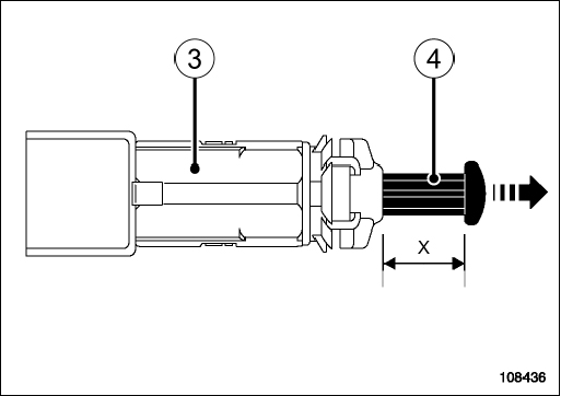

Here is the drawing and instructions for adjustment and replacement from the Renault manual.
I think the problem may be the "automatic adjustment feature".
