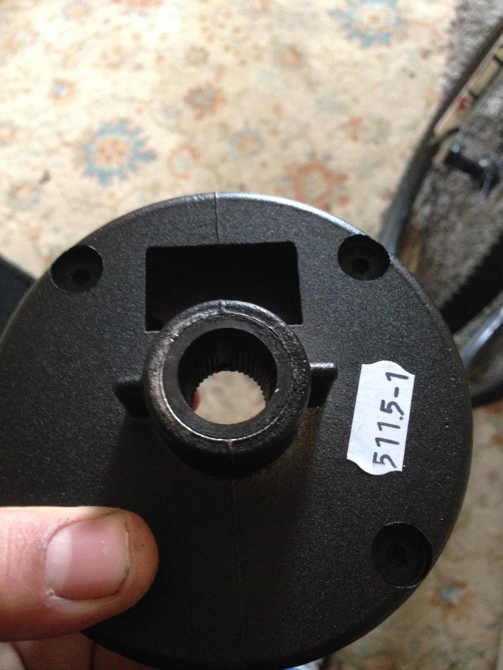

Can just about make out the two tabs in this pic.
  VW passat R
Hi James Thankyou for the fast reply, & the photo. So take off the steering Boss & check if it has them two black plastic Tabs on both sides? so do the two tabs connect to the steering angle sensor? if it hasn't got Tab's i will need to buy a Boss with Tab's. would i need to reset the steering angle sensor?

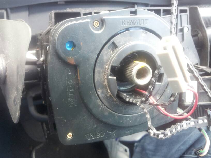

They slot into the angle sensor as you can see here
It should self clear the light once you fit one that has the tabs, unless the sensor has turned too far on it's rotation then it will require resetting.
JamesBryan
If it doesn't clear then Google Clio 182 steering angle reset and you'll find threads on here on how to do it.
It's to do with the blue and yellow dots in the clear window in the top left of the sensor.
