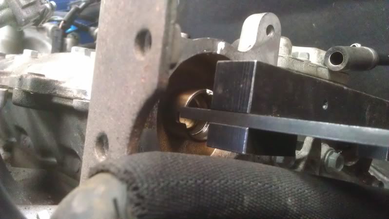

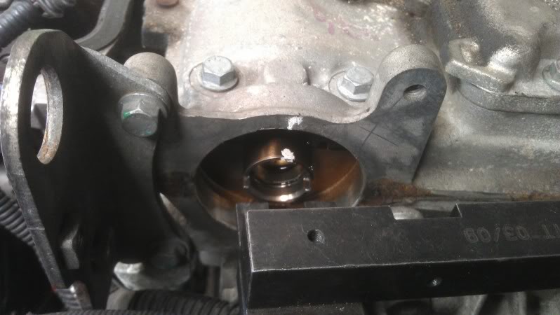

Tipex marks on pulley.....common place
Tipex marks on the end of tha cams!!!!!! WTF
  182/RS2/ Turbo/Mk1
Pretty cringeworthy on one of these engines.
Perfectly valid method on keywayed cams where all you need to ensure when doing a belt is that you are on the correct tooth, but not a good method for doing a floating setup.
Must say though that tipex has lasted well to still look so clean if its been inside the engine for a while like that!
  BMW E46 330ci Sport
So they used tipex to mark the position of the camshaft when fitting the new belt? Scientific!
  182/RS2/ Turbo/Mk1
and also pointless considering if they are just going to look at a tipex mark they may as well just look at the cams themselves, you can pretty much tell at a glance to more accuracy than they have achieved there just from if the 2 slots are pointing at each other like they should be or not.

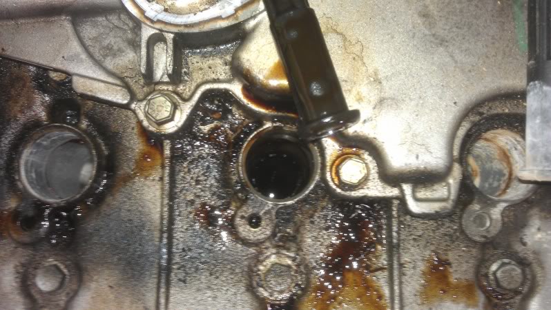

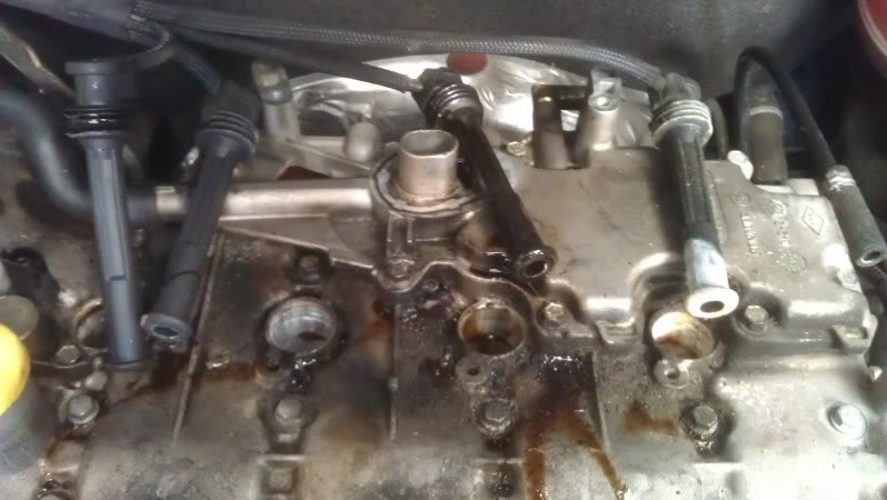

Yes Martyn, definitely done a botch on it. Tensioer wasn't adjusted, and I just found this when I was pulling the rocker cover off to reseal it
sparkplug on number 2 is totally submerged
  182/RS2/ Turbo/Mk1
oh dear, guessing it is going to need new spark plugs.
Surprised it wasnt already misfiring with that much oil on them, the carbon in the oil allows the spark to track down the outside of the plug, can actually knacker the leads too if left long enough.
