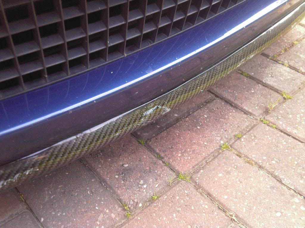

As above really scuffed the front of my Ktec carbon splitter against a curb last night. Any advice on polishing out the scuffs. they are reasonably deep in places. :dead:

pics of it? You could try polishing it i guess, but not sure if carbon fibre responds too well to that.

Yeah ill get some pics up tonight. Think it will need more than a hand polish. Machine polish may work?

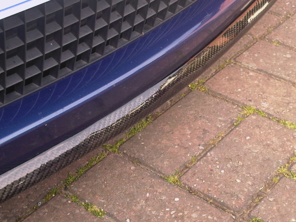

Well had a quick go at reparing it tonight. Will do it again properly at the weekend but wanted to see if it worked in principle.
BEFORE:
Pic doesnt really do the scratches justice. They are quite deep.
Sanded back the laquer with P1500 wet and dry, coloured the scratches in with Black permenant marker (a bit crap i know but actaully looks quite good), smoothed and re-laquered.

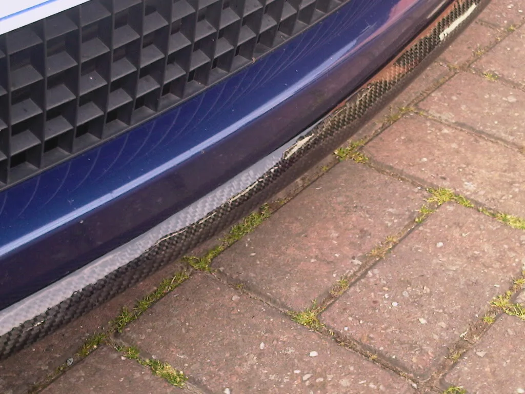

AFTER:
Quite pleased with the results but will do it again over the weekend to neaten things up as this was done in about 20 mins.

wow, from the after pic it doesn't look like there was any damage at all. If you didn't know it was there i'm sure you'd miss it. good job mate.
  Elise S1 B&C 140
Cheers mate :) - yeah pleased with the results, gonna do it again over the weekend though to tidy up as I ran out of laquer.
