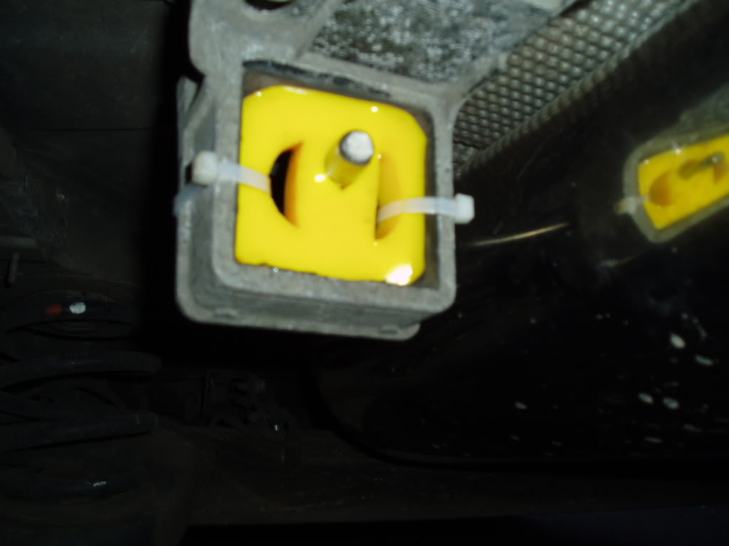

Tailpipes align alrite, i used the rubber mounts below, replacing the shite Renault provide.
