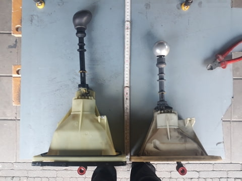

My Scenic shifter arrived today.
It's 8 cm's taller, and travel from 3rd to 4th is only 1 cm longer.
Also note that the Clio has a bend in it original, and the Scenic one is straight.
