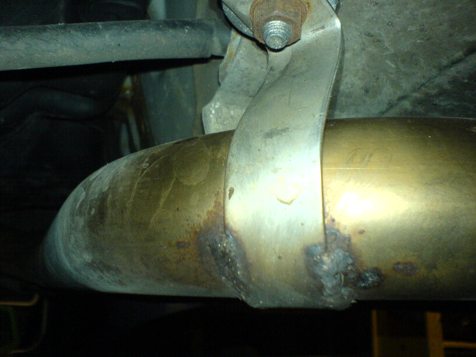

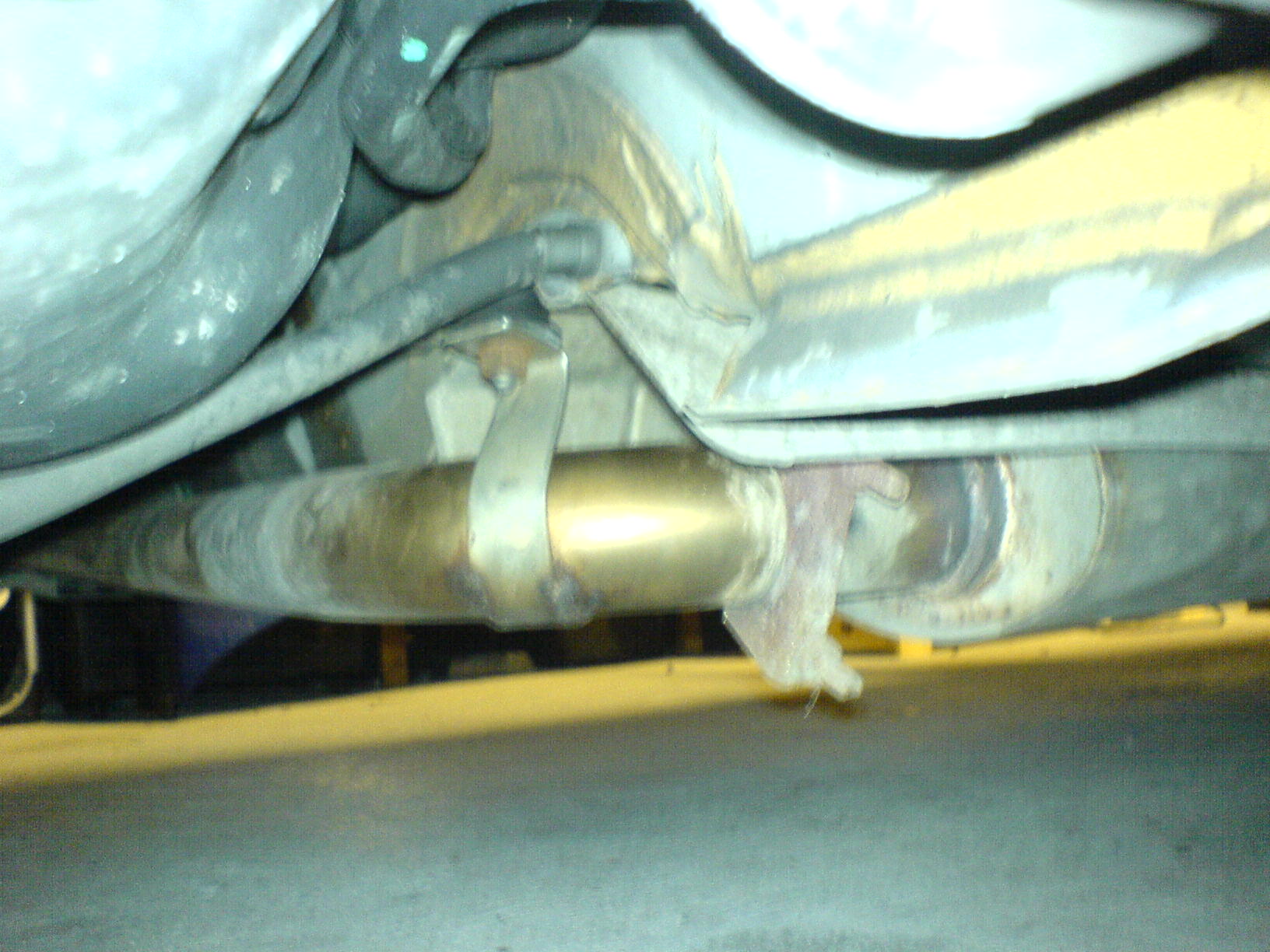

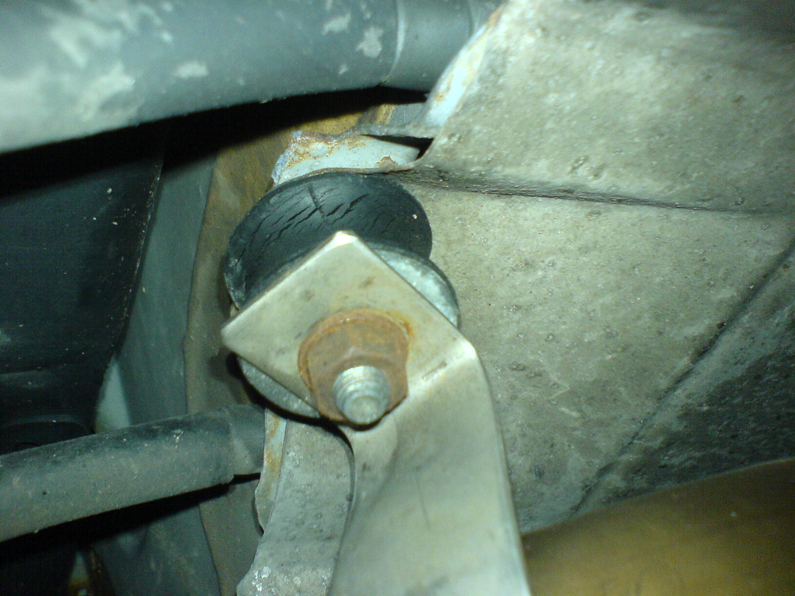

Heres what I did. 90 degree bend was worst for me too!

Thanks for posting the pics mate. Looks like a good way of sorting it. As I say I can't weld and I can't be bothered forking out for it but I might see if I can set something up to hold it up by wrapping round the exhaust. First thing is to tray refitting it though.
  Evo4, MITO, 172 TTV6
Bad pics as just held phone under car! but its hardly braking the bottom of the car underside. Well see if k-tec will supply the bits on cheap! Once you get them instead of welding drill a hole up the top by the top of pipe, then fold the bar around and drill a hole in the bottom and bolt the too bits together - although this will prob make a bit of a squel!
