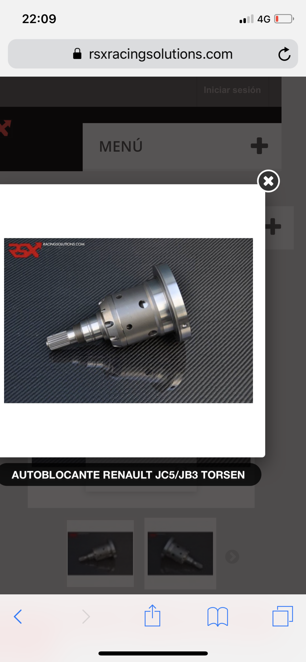

Has anyone heard of the company?
RSX racing solutions in Spain. They make a Clio lsd and cw&p.
The diff looks similar to quafie/m factory

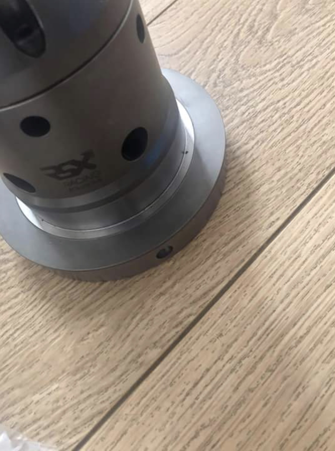

Ever so slightly, I just used a air belt sander to take a small bit of rough casting off, literally nothing!

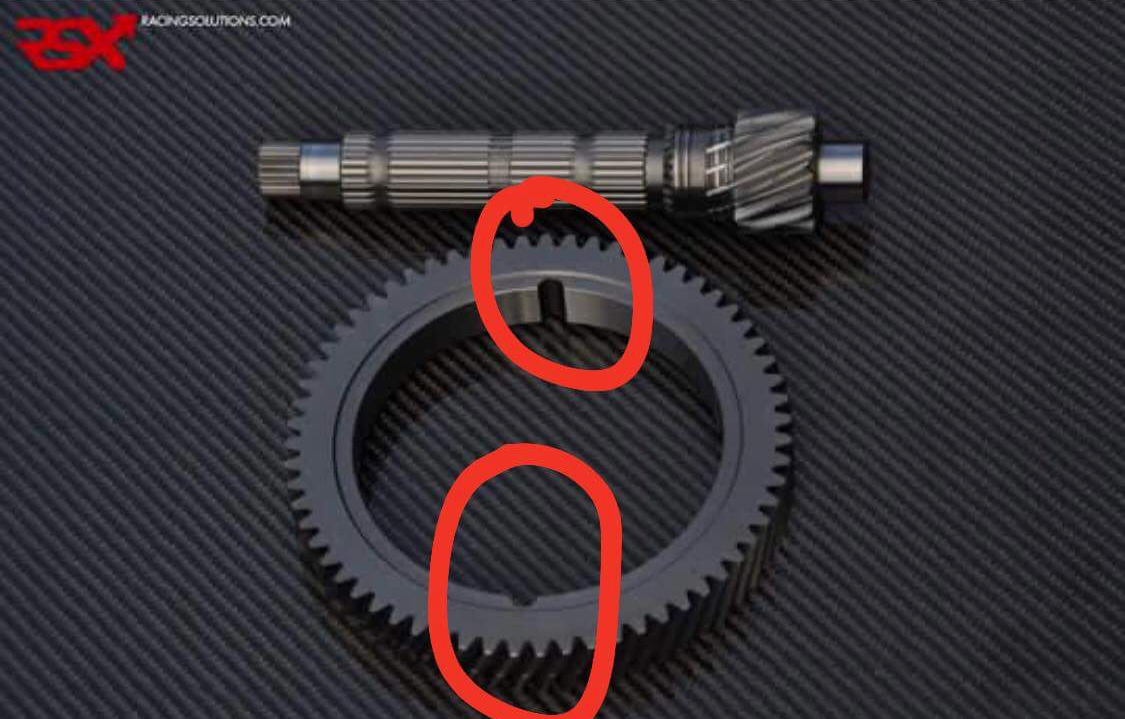

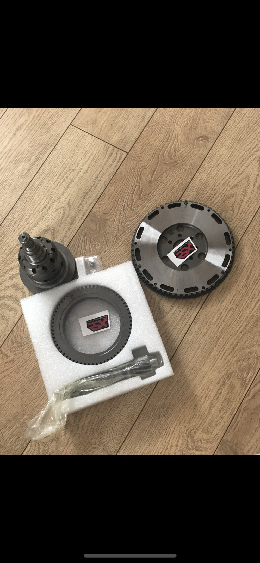

Could they not have fitted the crownwheel for you? Assume it fits as per the quaiffe (interference fit and 2 ball bearings)
This is where the problems come in. The picture they sold me as the crown wheel would have the slots for the ball bearing. But it hasn’t got them. It just gets pressed on. I could of got the slots machined but I’m going to get it welded on.
scotiamr2t
  Mazda 2, Ph1 172
@Nathan Evans personally i would be back in touch with them to complain and negotiate a discount (to cover the additional costs) or replacement CW&P with the proper slots as it should have.
